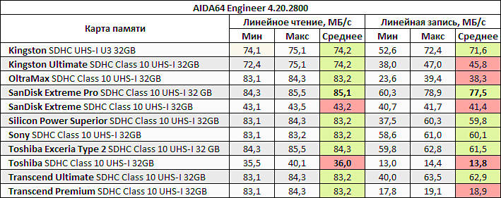

Check only "Запись seq", "Линейная запись" (Linear/sequental write).

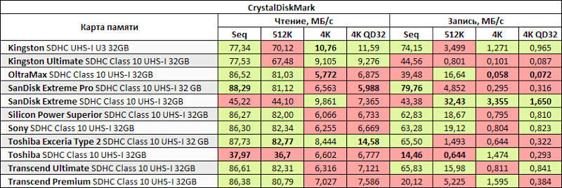

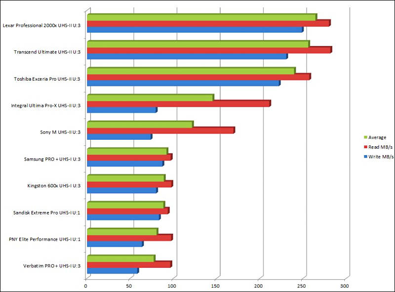

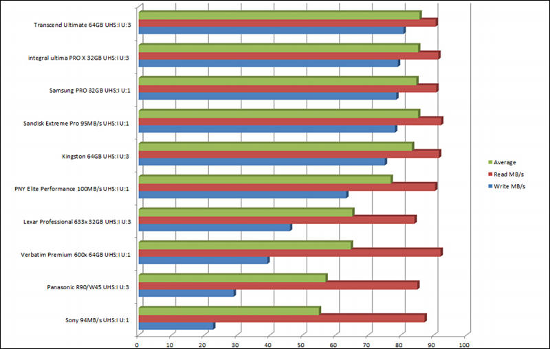

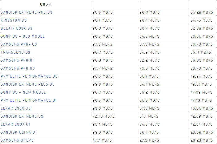

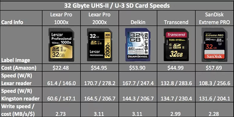

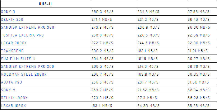

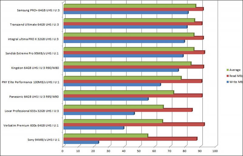

One more fast cards test including Lexar this time

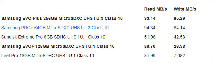

MicroSD cards
