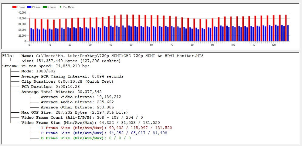

    @willianaleman I think you should double check your footage. With version 1.0 firmware it's possible to select 720/60p while using HDMI but the camera will actually record in 60i (actual interlaced, not just a wrapper). With version 1.1 firmware this has been "fixed" in that the 720p options are not selectable when you are using HDMI to eliminate any confusion.
  • @kavadni, thanks for the observation. I'm going to check into that later tonight with StreamParser 2.6. I will get back with the results.
  • @willianaleman,
    Are you saying that you can still 'select' 720p in mode when HDMI connected?
  • @kavadni, alcomposer. Sadly, Kavadni is right. I double checked the footage recorded at 720p with StreamParser, 2.6. The result is that the final output is 1080i, even when the recording mode setting is 720p. I believe that this is nothing new for the majority of the users here. By the way, please don't pay attention to the numbers in the screenshot, the recording was done just to test the HDMI output at "720p. It is a screen saver recording."image
