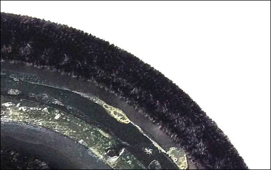

  • Example of X1 ear pads construction issue
    If you want closely you'll see that velour pads are not glued to plastic directly, but instead attached to faux leather circle and this in turn is glued to plastic.
    During prolonged use this faux leather will break, 100% no exceptions, just depend on time. Usually it happens in one place after this it will be torn out fully.
    Note - usually you do not have so much glue residue as on this photos, mine was clear.
    Note - make sure to remove pads carefully as they are glued and also have 4 fixing plastic things.
    Other side is glued to plastic, so will live until you will torn all pads.
    Only good thing here is that velour edge is enforced.
