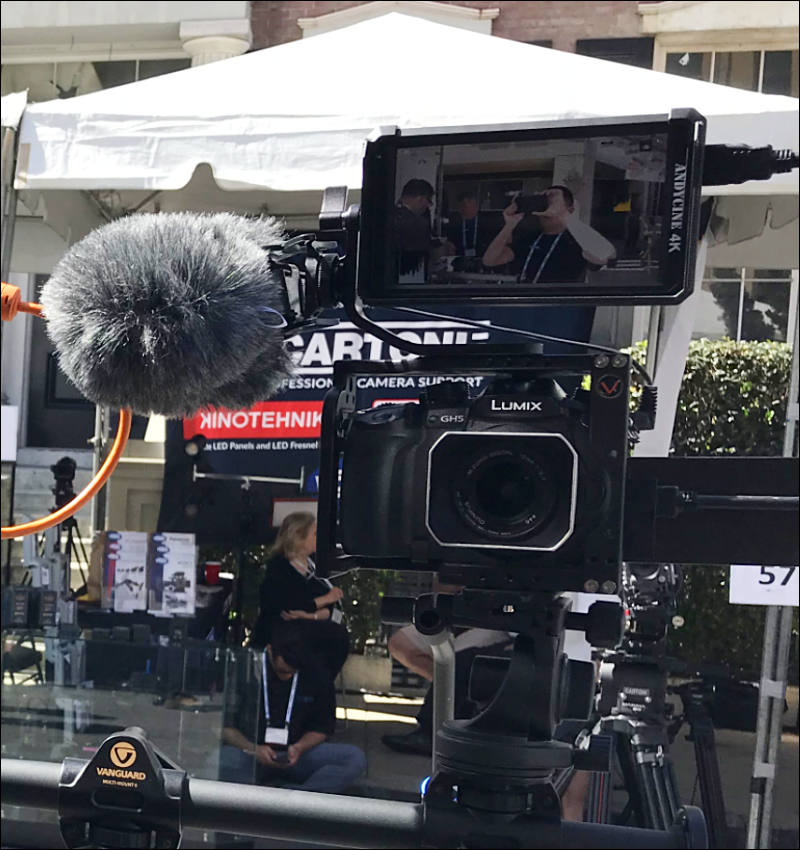

  • Used for our team rig at Cinegear 2018
    800 x 850 - 106K

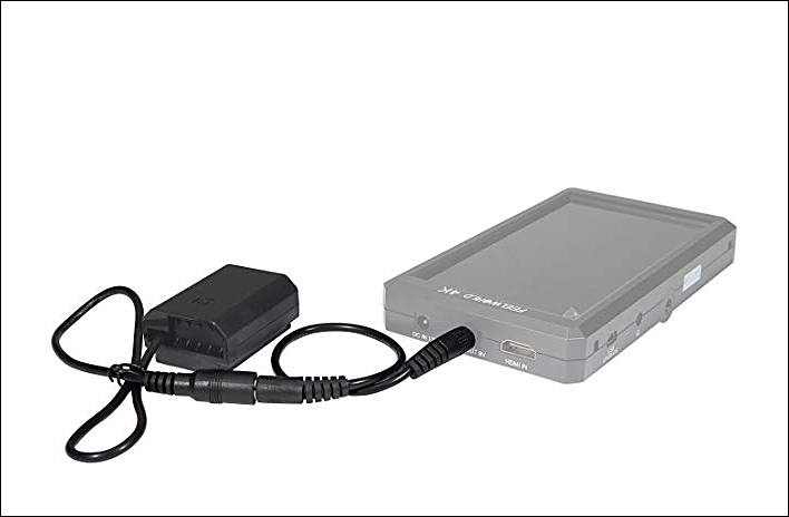

  • Dummy Battery DC Coupler for SONY NP FZ100 Dummy Battery Converter Compatible for Sony Alpa A7III, A7RIII,Sony A9 Digital Cameras
    https://www.amazon.com/dp/B07D72CL1Z
    708 x 464 - 26K

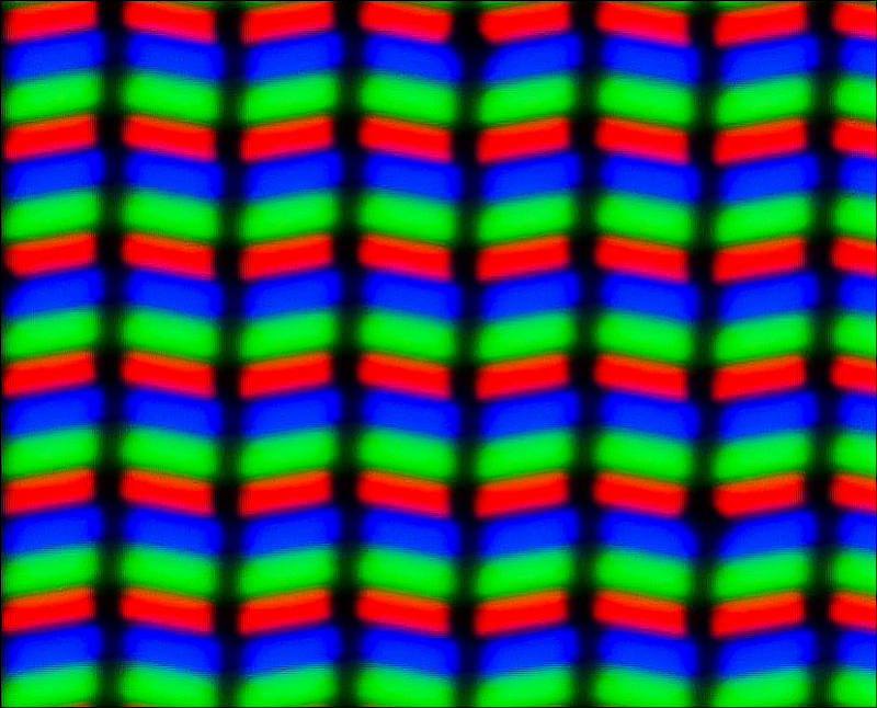

  • IPS panel macro photo
    800 x 646 - 96K

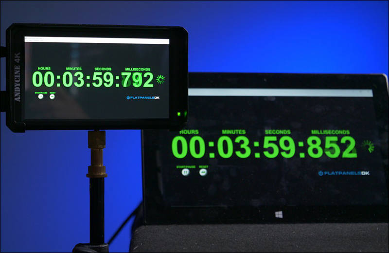

  • Delay at 1080p60
    Quite typical for such monitors

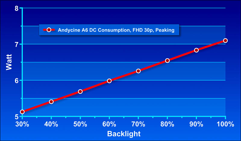

  • Andycine A6 monitor electrical measurements
    • Panel cutoff battery voltage - 6,05v
    • Panel cutoff DC Input voltage - 5,91v
    Standby consumption - 0,058 watts
    800 x 469 - 56K

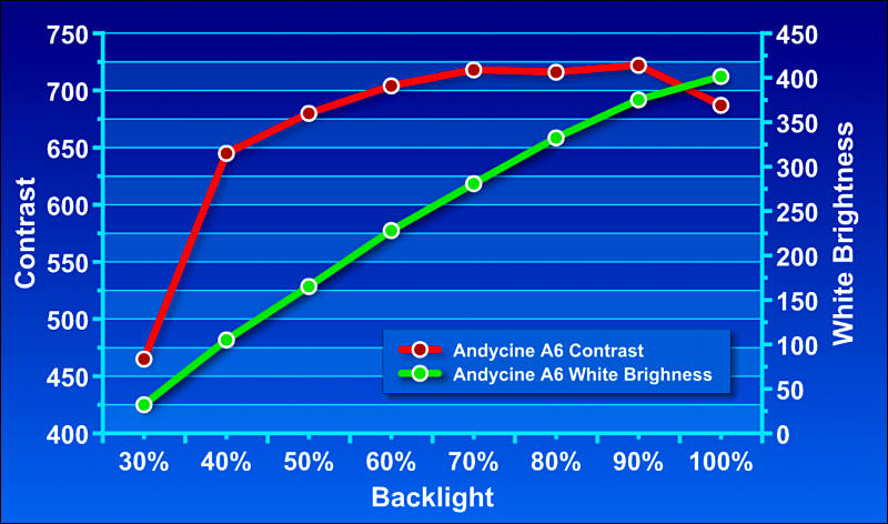

  • Andycine A6 Contrast and White Brightness at various backlight settings
    800 x 472 - 87K
  • Let's compare efficiency to Lilliput A5
    Maximum brightness is 403 nits versus 349 nits for A5, 15% brighter.
    With this difference monitor consumes 5.4% less energy, so it is around 22% more efficient total.
    Can add also 20% more battery life space due to lower voltage cutoff, and larger panel.

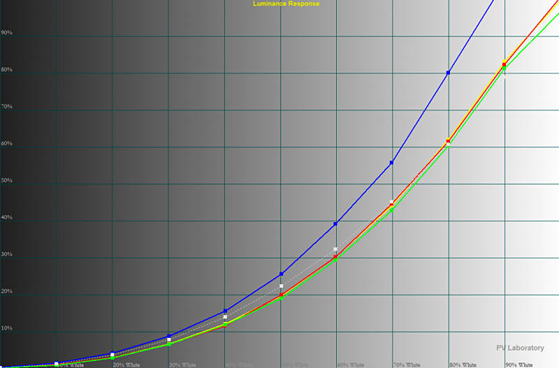

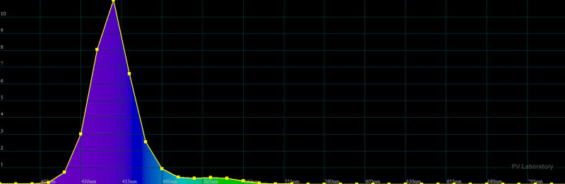

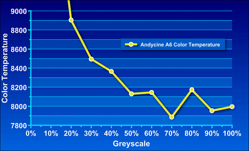

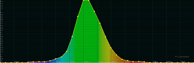

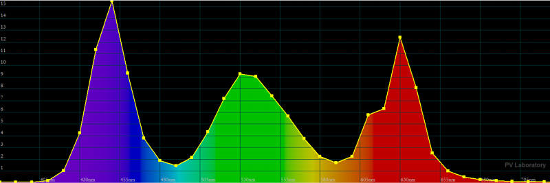

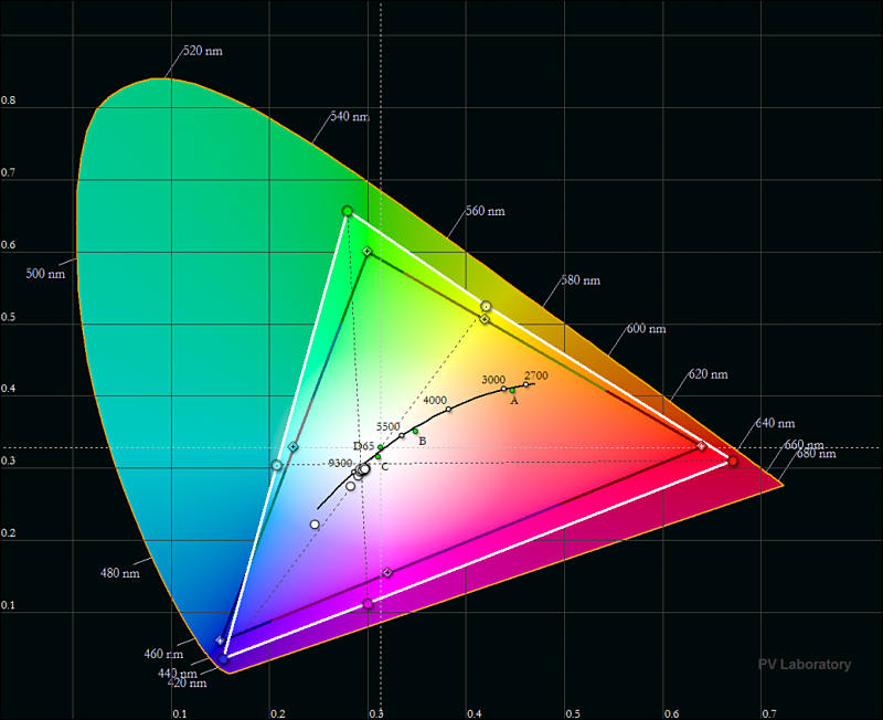

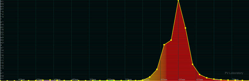

  • Color gamut, grayscale
    Gamut is wider than Rec 709
    Also it is nice idea to adjust blue down
    As it is really cool color temperature overall
    Primaries spectrums
    White spectrum
    800 x 652 - 73K
    800 x 527 - 54K
    800 x 261 - 48K
    800 x 262 - 50K
    800 x 261 - 26K
    800 x 267 - 40K
    800 x 484 - 73K

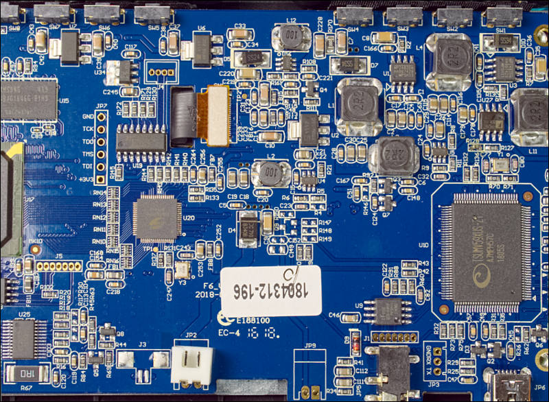

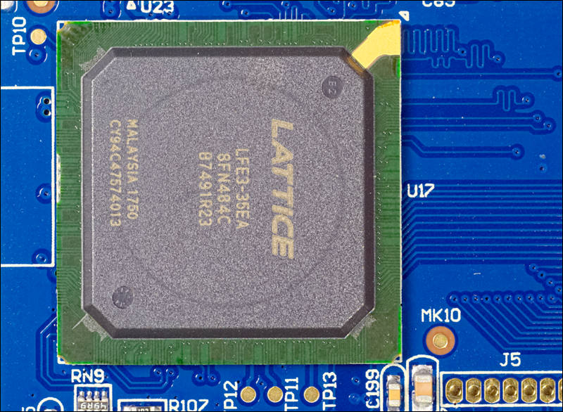

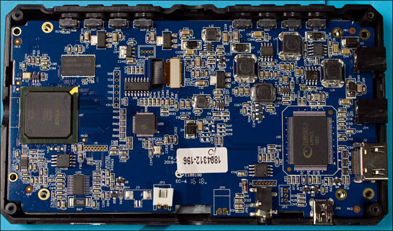

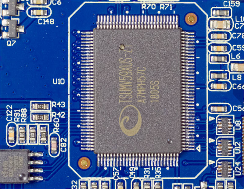

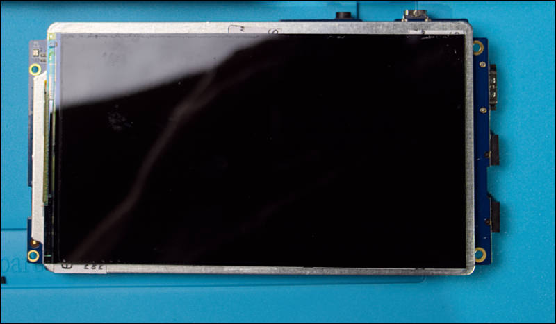

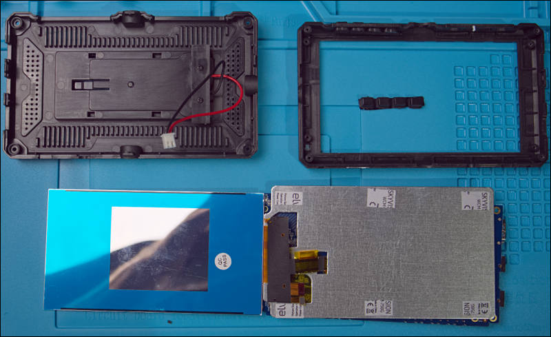

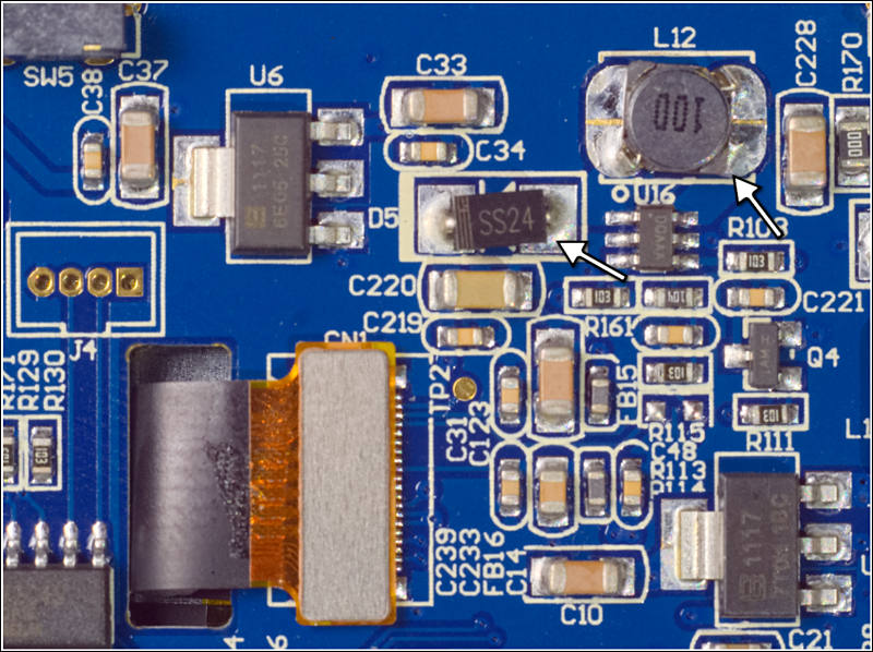

  • Andycine A6 Inside
    Main parts
    LCD Panel
    Very nice main board, good quality manufacturing
    Nice PCB and lot of components
    TSUMV59XUS LSI
    TSUMV59XUS is a highly integrated TV SoC solution for advanced analog television platform. Integrating latest advanced technologies from Mstar Semiconductor, the world leading TV SoC provider in TV industry, TSUMV59XUS provides cost-efficient solution for multimedia TV application with attractive features.
    1. Analog TV Front-End Demodulator
    2. Multi-Standard A/V Format Decoder
    3. The MStarACE-6 Video Processor
    4. Home Theater Sound Processor
    5. Embedded Memory
    6. Transport-Stream Input for Extended DTV System
    7. Peripherals and Low-Power Standby Mode
    Lattice Semiconductor LFE3-35EA-8FN484C FPGA Chip
    Most expensive thing in monitor.
    • Number of LABs/CLBs - 4125
    • Number of Logic Elements/Cells - 33000
    • Total RAM Bits -1358848
    • Number of I/O - 295
    Only issues found with automated soldering
    Non ideal placement for few large passive elements.
    800 x 489 - 66K
    800 x 467 - 42K
    800 x 471 - 126K
    800 x 586 - 172K
    800 x 620 - 146K
    800 x 586 - 122K
    800 x 598 - 122K

  • wow that's an excellent review. I'm wondering why can't the monitor provide power-out via usb rather than using a battery adapter, seem a bit cumbersome.
  • @pureaxis
    Well, it is all in reverse, as it is way most cameras work best.
    With USB power you either can't power camera at all or it overheats (as try to charge battery or lot of other stuff.
