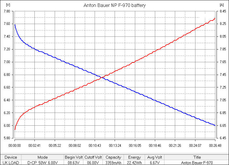

    Sony NP compatible battery, UK Lab, discharge from fully charged state, 50W constant load
    Note that 50W load is little big for such batteries, lights usually draw maximum 30W from them.

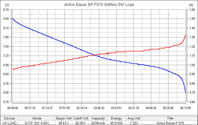

  • Sony NP compatible battery, UK Lab, discharge from fully charged state, 8W constant load
    8W load is typical for Panasonic GH5 4K recording mode as well as Canon DSLR video recording modes.

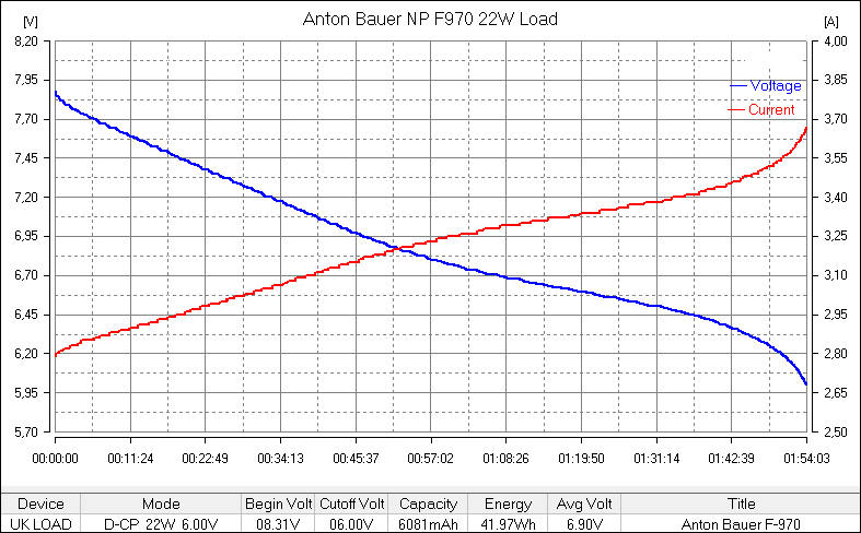

  • Sony NP compatible battery, UK Lab, discharge from fully charged state, 22W constant load
    22W load is typical for powerful Aputure LED lights using double NP batteries.

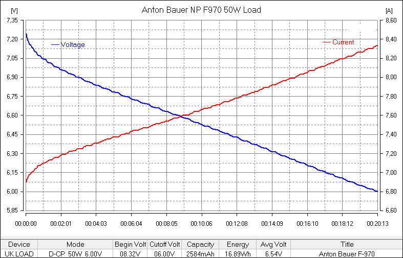

  • Sony NP compatible battery, UK Lab, discharge from fully charged state, 50W constant load
    50W load is really too much for such batteries. It is close to consumption of CAME-TV 55 Boltzen Fresnel.
