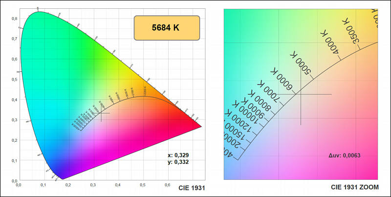

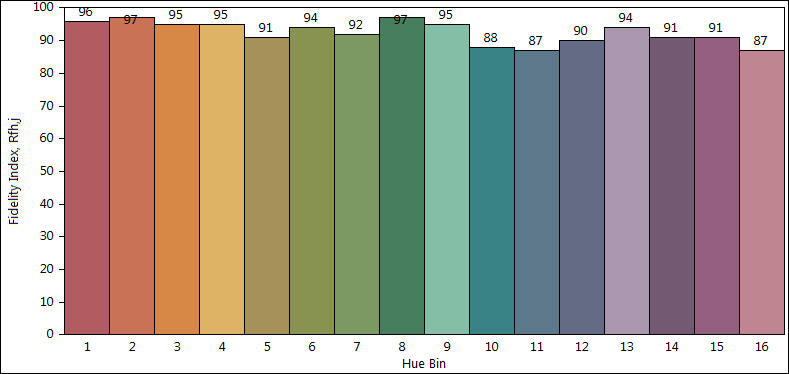

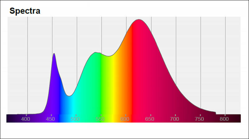

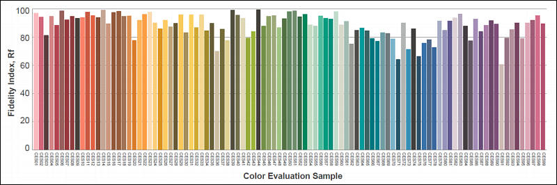

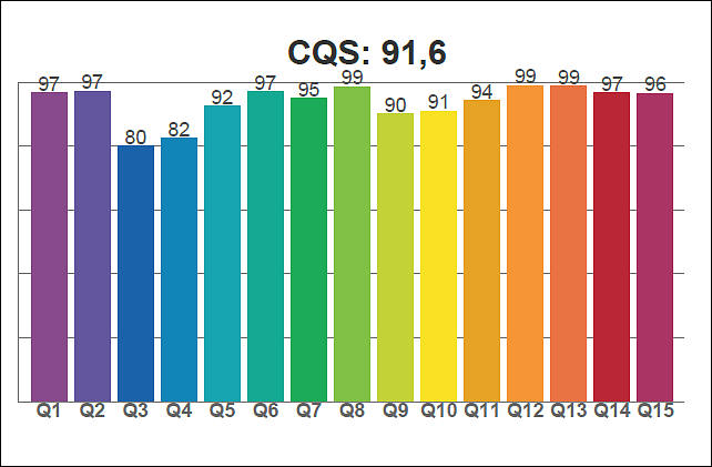

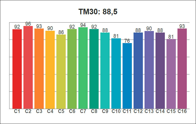

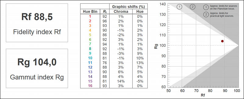

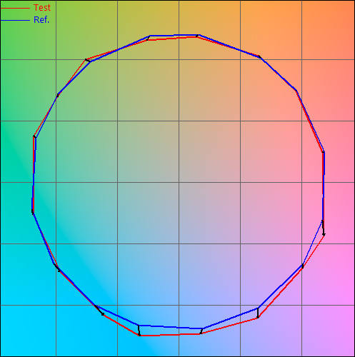

F&V Z720S UltraColor (Bi color, daylight setting), measurement using Lisun, Russian Lab processing

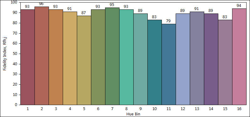

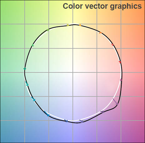

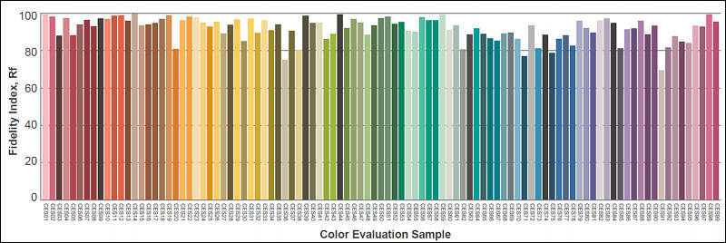

Focus on TM30 and CIE 224 and look for color distortion and Rf values.
F&V Z720S UltraColor is good light with proper color temperature, light quality is quite good and suitable for videos.

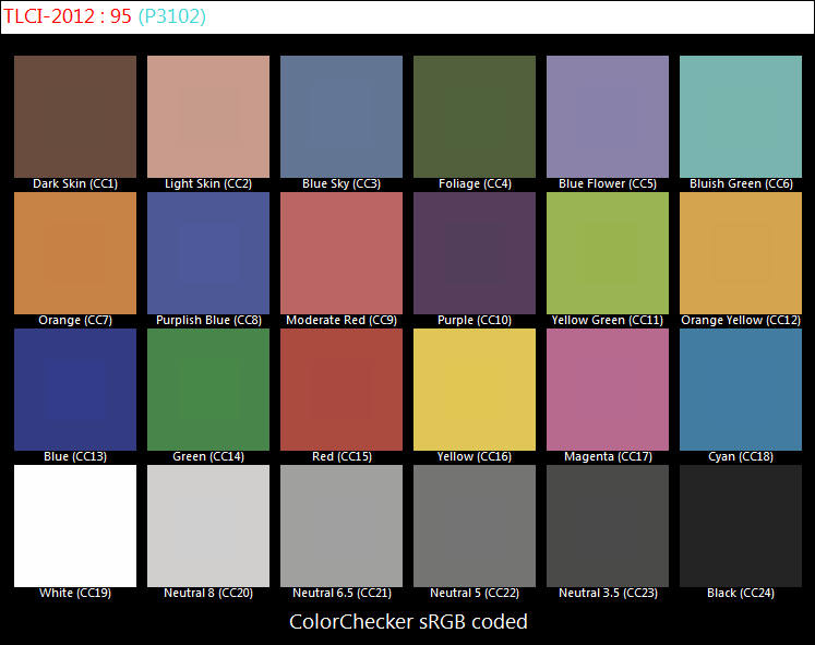

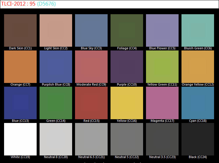

As you can see, TLCI claimed value matches measurement exactly.

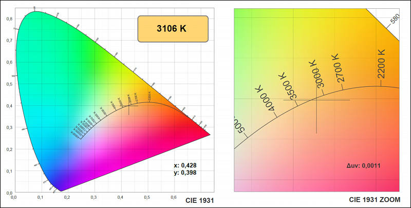

Color temperature

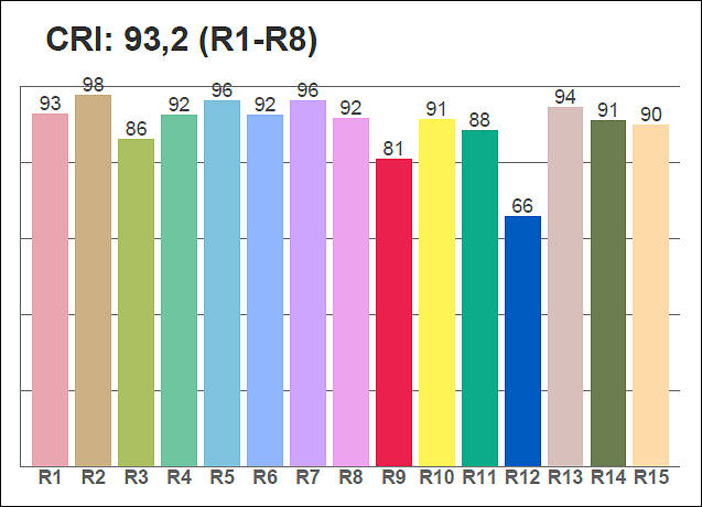

CRI color quality
CQS color quality
TLCI 2012

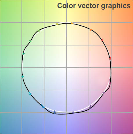

TM30 color quality
TM30 details
CIE 224 2017 (Rf = 90)

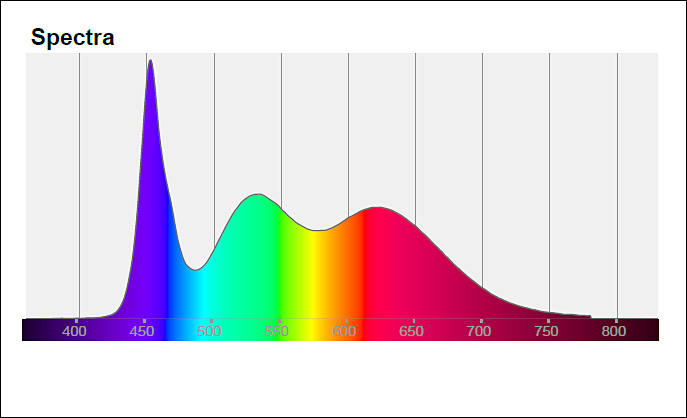

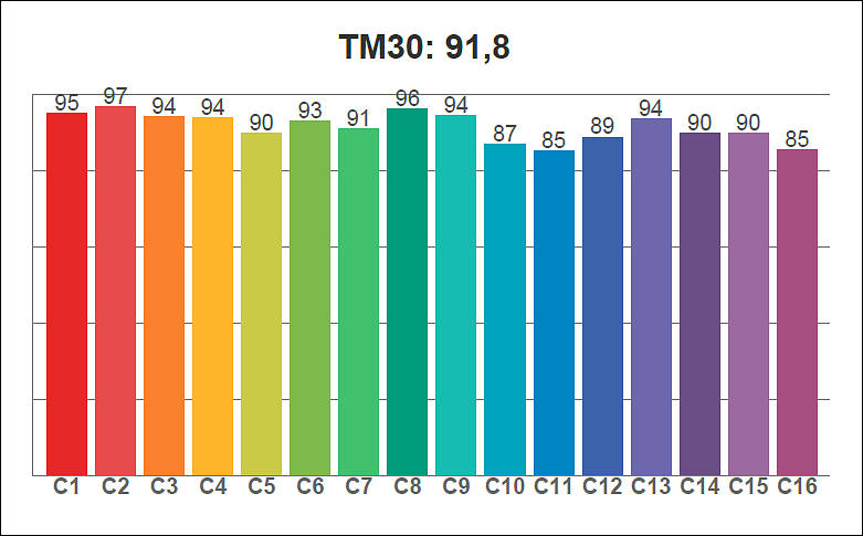

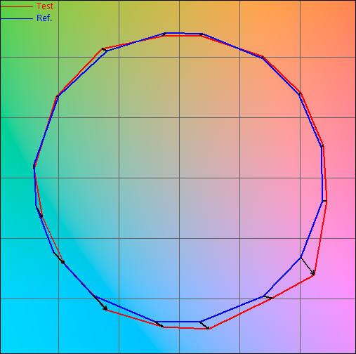

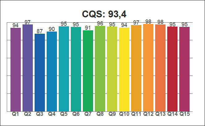

F&V Z720S UltraColor (Bi color, tungsten setting), measurement using Lisun, Russian Lab processing
F&V Z720S UltraColor is good light with proper color temperature, light quality is good and suitable for videos.
Color temperature
CRI color quality
CQS color quality

TM30 color quality
TM30 details
CIE 224 2017 (Rf = 93)
