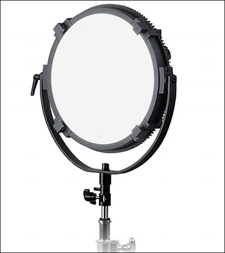

Fotodiox Pro FACTOR Jupiter12 led light
    • Powerful softlight without the need for diffusion - without the traditional shortcomings (multiple shadows, uncomfortable intensity) of conventional LED panels.
    • The Factor light is ready to go for both photo and video right out of the box - no extra diffusion or accessories to add.
    • AC adapter locks into V Lock battery mount, or attach optional V lock battery optional for totally wireless operation
    • Draws a maximum of 55 watts, so can connect to any household electrical circuit. Durable all-metal construction, ready for studio and location work.
    • Rear backlit LCD displays percentage of light output, color temperature, remaining battery level, and DMX channel information
    • Optional Honeycomb Grid to concentrate light's beam angle to 90 degrees. Also available: Creative Masks for catchlight and reflective effects.
    • Around $529

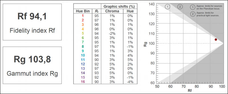

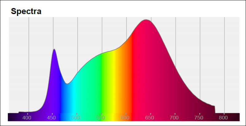

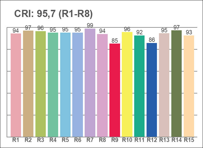

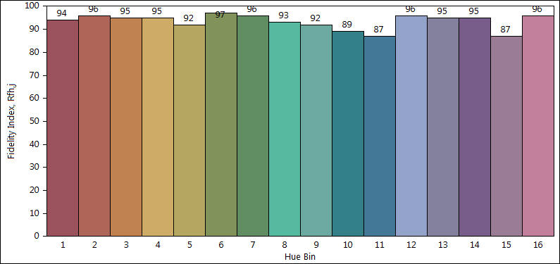

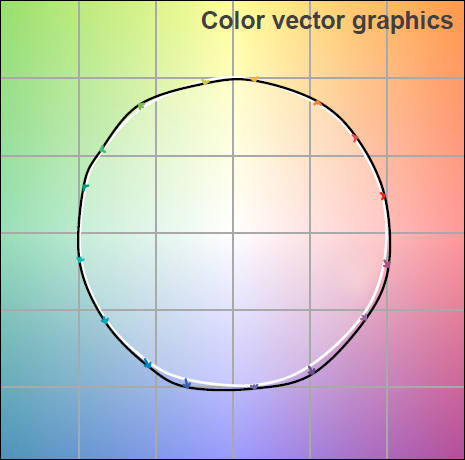

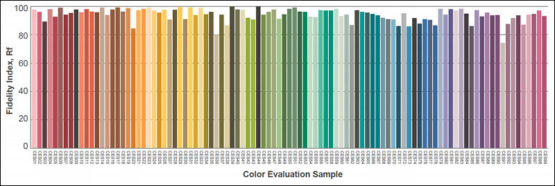

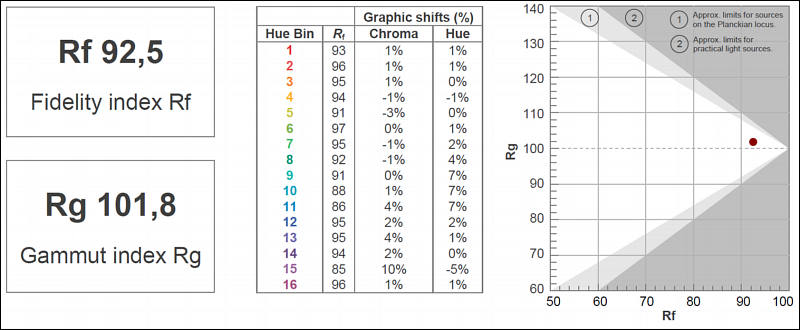

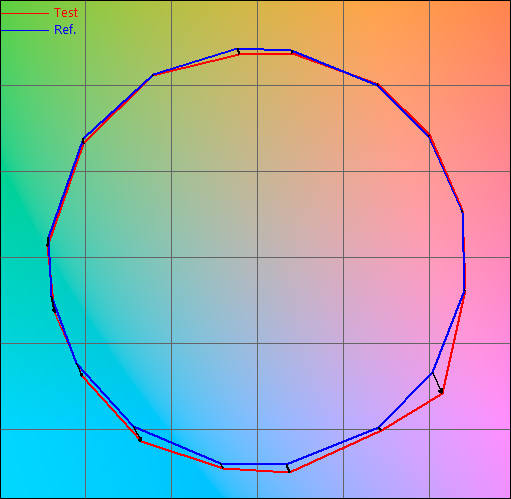

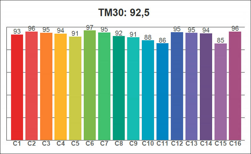

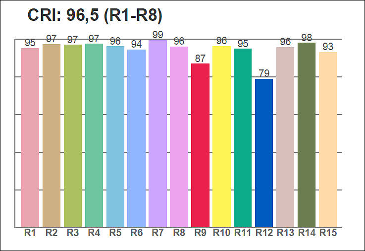

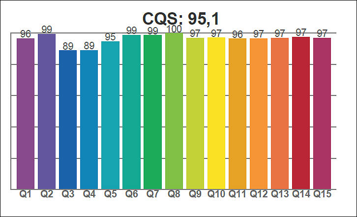

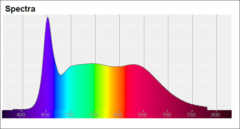

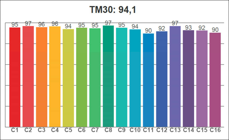

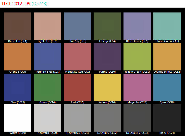

  • Fotodiox Pro FACTOR Jupiter12 (daylight setting), Measurement using CV600, Russian Lab processing
    Focus on TM30 and CIE 224 and look for color distortion and Rf values.
    Fotodiox Pro FACTOR Jupiter12 is good light with good color temperature, light quality is very good. Suitable for videos.
    Color temperature
    CRI color quality
    CQS color quality
    TLCI 2012
    TM30 color quality
    TM30 details
    CIE 224 2017 (Rf = 93)

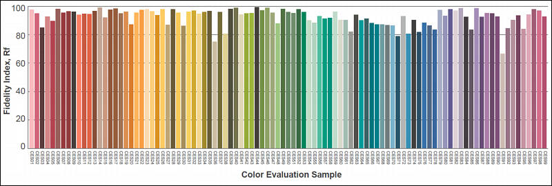

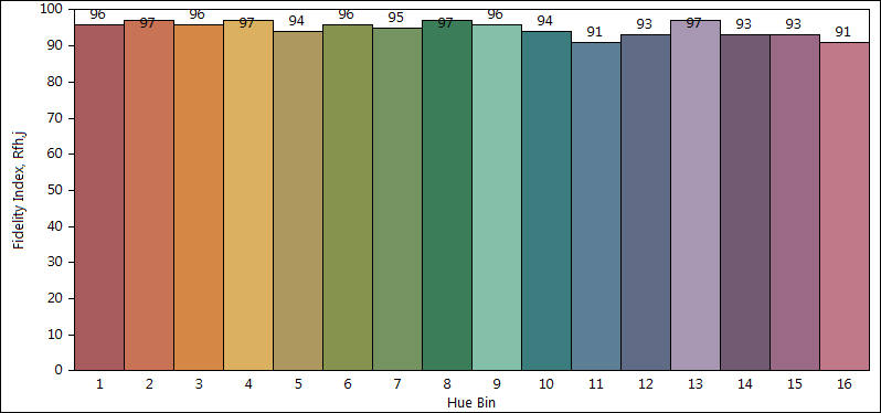

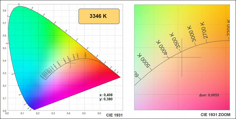

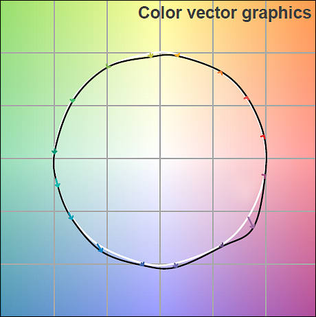

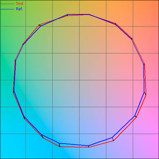

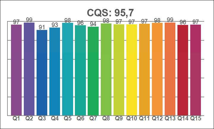

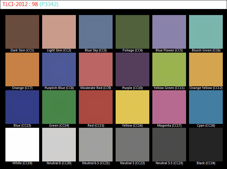

  • Fotodiox Pro FACTOR Jupiter12 (tungsten setting), Measurement using CV600, Russian Lab processing
    Color temperature

    CQS color quality
    TLCI 2012
    TM30 color quality
    TM30 details
    CIE 224 2017 (Rf = 95)
