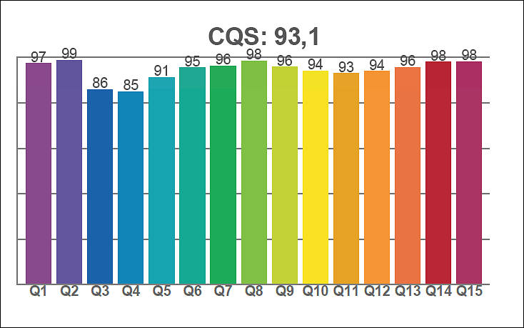

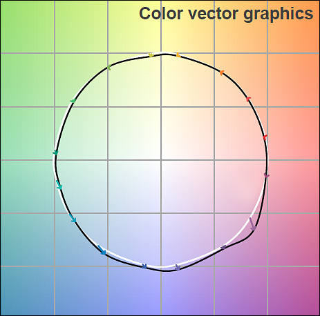

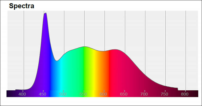

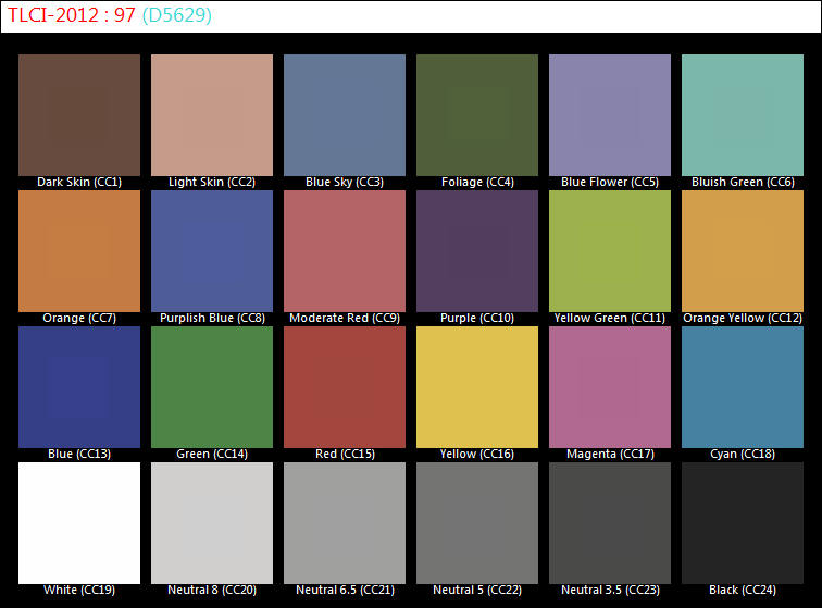

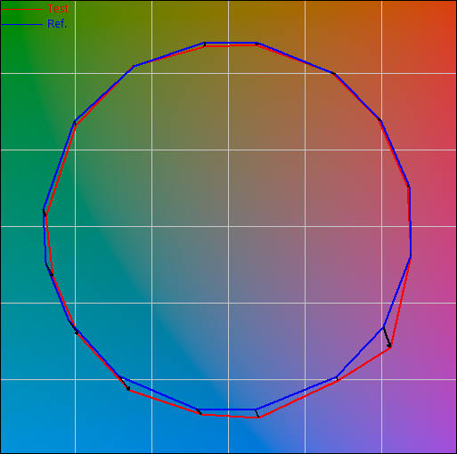

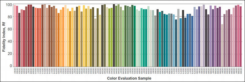

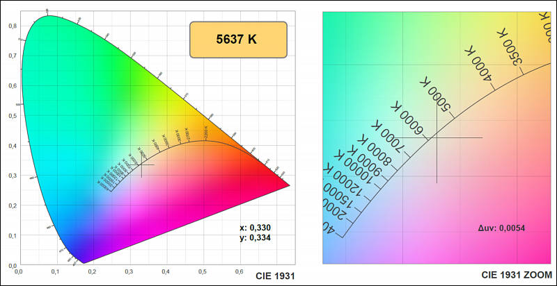

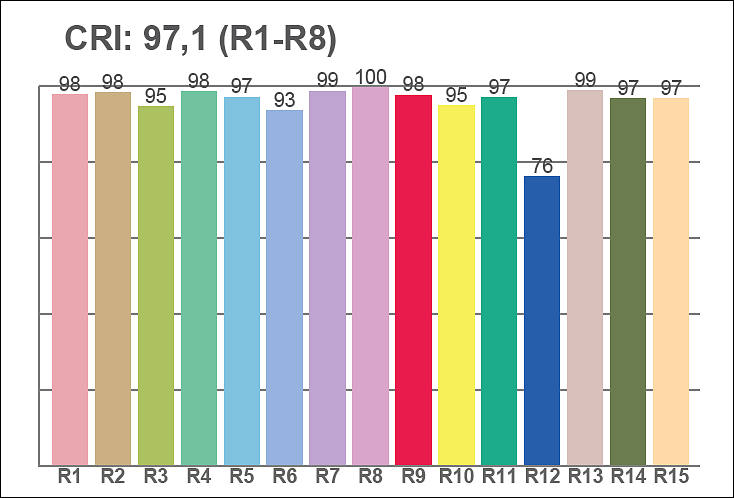

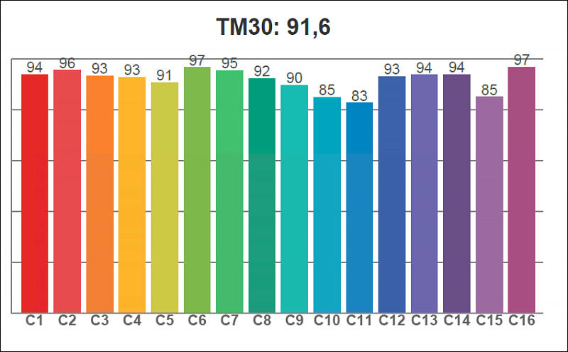

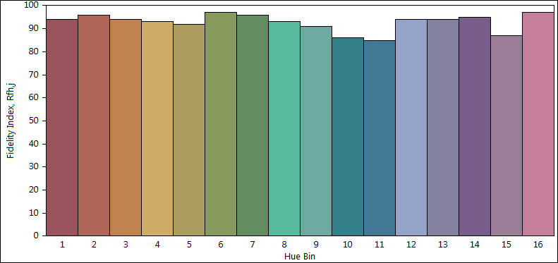

  • CAME F-150W (daylight version), Measurement using CV600, Russian Lab processing
    Focus on TM30 and CIE 244 and look for color distortion and Rf values.
    CAME F-150W is good light with proper color temperature, light quality is very good and suitable for videos.
    Color temperature
    CRI color quality
    CQS color quality
    TLCI 2012
    TM30 color quality
    TM30 details
    CIE 244 2017 (Rf = 93)

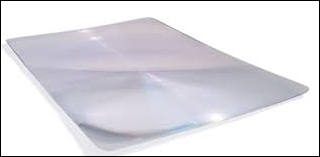

  • @Psyco
    Fresnel lens not necessary have big grooves. This one have circular grooves that is much smaller, but construction is same.
    For example this is reading Fresnel lens.
