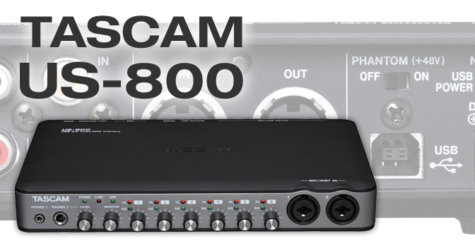

Tascam US-800 as standalone mic preamp with monitoring
    http://www.ebay.com/sch/i.html?_trksid=p5197.m570.l1313&_nkw=tascam%20us-800&_sacat=0&_clu=2&_fcid=168&_localstpos&_stpos&gbr=1
    Can be pretty useful if you run many 48v powered mikes and need to monitor sound (it has two outputs and form factor is quite good).
    You can run it in standalone mode. And even use any cheap digital recorder, as it also output signal in digital.
    672 x 352 - 61K

  • Tascam has an entire line that goes from small ultra portable USB powered Pres. The US800 has a 5v input and seems that standalone mode is powered from that input and not the USB input. This is what the manual says about Stand Alone Mode:
    When this unit is not connected to a
    computer by a USB cable and the unit’s power
    is ON (the included TASCAM PS-P520 AC
    adaptor is connected), the unit will operate in
    stand-alone mode. In this mode, you can use
    this unit as a microphone preamp without
    using a computer.
    Settings for stand-alone
    mode
    In stand-alone mode, input signals pass
    through the digital mixer, which is set to fixed
    values, and then the output selectors before
    being output from the output jacks.
    Mixer
    The mixer settings are fixed at the following
    values.
    Faders: All set at 0 dB
    Pan: Odd channels are set to the left
    channel and even channels are set to the
    right
    Mute: All OFF
    Solo: All OFF
    Stereo link: OFF
    There is no on/off switch on the unit.
