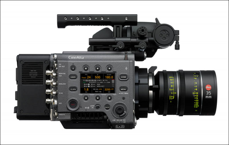

Sony New CineAlta Venice
    • Full-Frame CMOS Sensor, 24.7M (total), 24.4M (effective)
    • Lot of Built-In ND Filters - Clear, 0.3(1/2), 0.6(1/4), 0.9(1/8), 1.2(1/16), 1.5(1/32), 1.8(1/64), 2.1(1/128), 2.4(1/256)
    • Native ISO 500
    • PL Mount or E-mount (lever lock type, without supplied PL lens mount adaptor)
    • Latitude - 15+ Stop

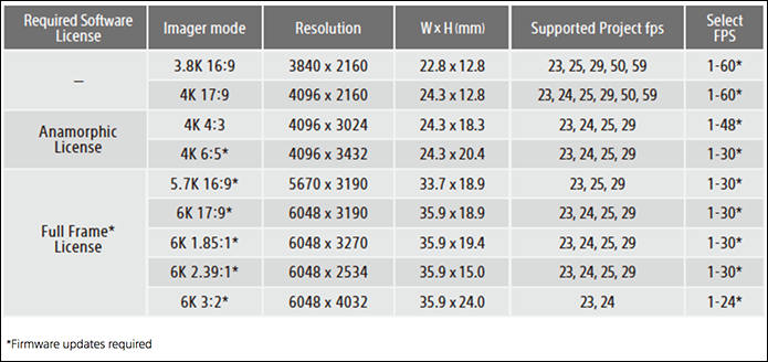

    • Modes - 3.8K 16:9, 4K 17.9: 1-60FPS, 4K 4:3: 1-48FPS, 4K 6:5, 5.7K 16:9, 6K 17:9, 6K 1.85:1, 6K 2.39:1: 1-30FPS, 6K 3:2: 1-24FPS
    • S-Log3
    • Record formats
      • XAVC 4K Class480: 23.98p, 24p, 25p, 29.97p
      • XAVC 4K Class300: 23.98p, 24p, 25p, 29.97p, 50p, 59.94p
      • XAVC QFHD Class480: 23.98p, 25p, 29.97p
      • XAVC QFHD Class300: 23.98p, 25p, 29.97p, 50p, 59.94p
      • MPEG HD422(1920x1080): 23.98p, 24p, 25p, 29.97p, 50i, 59.94i
      • HD ProRes 422HQ*: 23.98p, 24p, 25p, 29.97p, 50p, 59.94p, 50i, 60i
      • HD ProRes 422*: 23.98p, 24p, 25p, 29.97p, 50p, 59.94p, 50i, 59.94i
      • HD ProRes 422 Proxy*: 23.98p, 24p, 25p, 29.97p, 50p, 59.94p, 50i, 59.94i
    • BNC×4, (12G, 3G, 1.5G-SDI) connectors
    • HDMI Output
    • ExpressCard/34 slot×2, SD card slot ×1
    • 133 x 159 x 172 mm
    • Approx. 3.9kg (8lb 10oz)

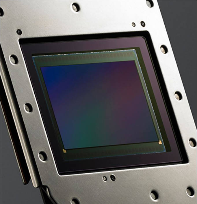

    Sony Electronics is announcing plans for its next-generation CineAlta digital motion picture camera system. This latest addition to the CineAlta family is being developed through careful research and close collaboration with creative professionals including Directors, Cinematographers and Digital Imaging Technicians. Through the implementation of features demanded by the industry, Sony is demonstrating its commitment to innovation and the creative freedom needed for feature filmmaking and production.
    Technology highlights and key benefits:
    • Full Frame 36x24mm sensor exclusively designed for this Digital Motion Picture Camera
    • Aspect ratio-agnostic – including Full Frame, Super35 4K 4-perf 4:3 Anamorphic and 4K spherical 3-perf 17:9
    • New image sensor enabling exceptional picture quality
    • Maintains the workflow established with Sony’s 16bit RAW/X-OCN and XAVC
    • Compatible with current and upcoming hardware accessories for CineAlta cameras (DVF-EL200 Full HD OLED Viewfinder, AXS-R7 recorder, AXS-CR1 and AR1 card reader, AXS and SxS memory cards).

    License options for individual production requirements
    With VENICE, Sony is giving users the option to customize their camera by enabling the features needed, matched to their individual production requirements. Optional licenses will be available in permanent, monthly and weekly durations to expand the camera’s capabilities with new features including 4K anamorphic and full frame, each sold separately.
    The VENICE CineAlta digital motion picture camera system is scheduled to be available in February 2018.
    695 x 328 - 49K
  • License options for individual production requirements

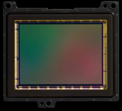

  • One of Japanese sensor blogs spotted one thing.
    In Venice making of video you can briefly see sensor and it happens to be 1:1 same to Sony A9 sensor
    As the complexity rise unification also happens across products.
    LSI can be different, of course, but can be even same with bigger memory and better cooling.
