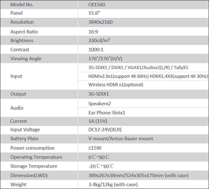

  • If you want some manufacturer who understand that he is doing and makes Rec 709 calibrated stuff with better panel
    May be features are not so high, but from simple practical standpoint it is better

  • I really need Luts and falsecolor. Are those neway panels color accurate?
  • As far as I know they work on LUTs.
    Do not know why it do not have false color, as it is standard option for all their small monitors.
    Yep, normally they are Rec 709.
  • Hm for those don't do the trick for me. But we will see what they will come out with :) thanks for posting them though. I like the four inputs as I do multicam shoots.
