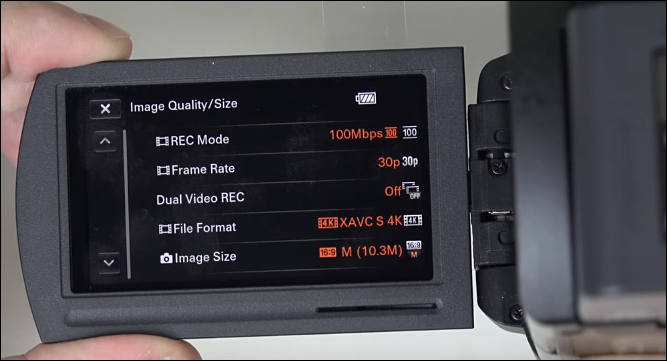

  • It is 3 menu elements that set it all
    Look at mid of
    and
    667 x 361 - 30K
  • Hi Thank you, but this still does not help. You see when I select XAVC S HD , it still records in 1440 X 1080 in stead of 1920 X 1080. i know this for i use adobe premiere to edit.
  • @filmchickie
    It is all 3 options that define recorded media, not one.

  • I select FileFormat - XAVC SHD I select FRame Rate at 30p. Dual Video Rec is OFF Rec Mode is 50 MBS.
    I shoot the footage and load it into premiere and the size of the frame is 1440 X 1080. I need it to be 1920 X 1080, why can't it shoot that at 30fps
