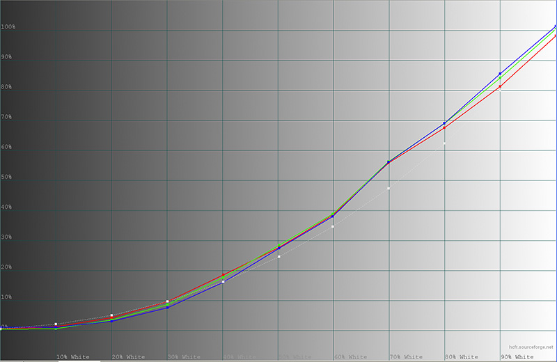

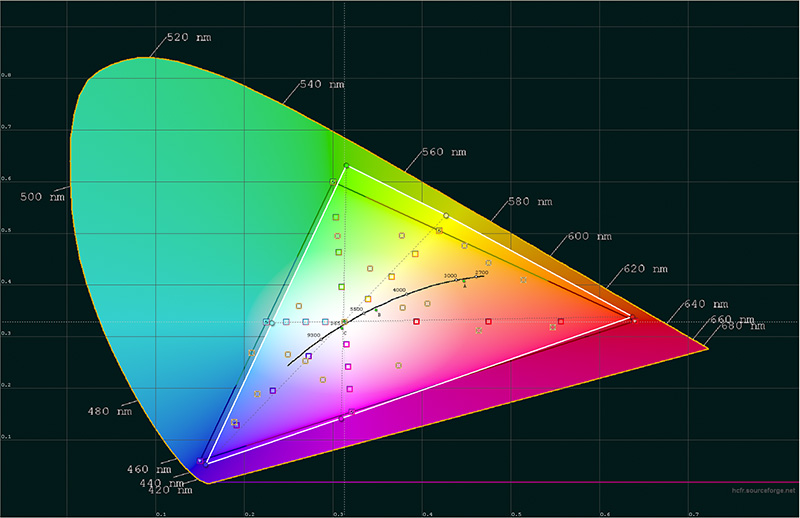

    A few tests after adjustments of RGB levels and contrast.
    Measurements made using Spyder 4 colorimeter.
