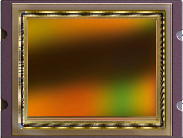

  • CMOSIS a member of the ams AG (SIX: AMS) group, a leading provider of high performance sensors and analog ICs, today launched the CMV50000, an industry first global shutter CMOS image sensor offering high resolution of 48Mpixels, more than twice the resolution of its previous generation CMOSIS global shutter CMOS image sensors.

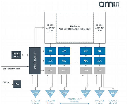

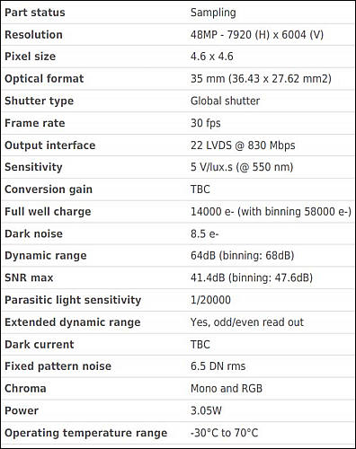

    The CMV50000 is a medium format 48Mpixels sensor with 7920 x 6002 4.6-µm sized pixels using the patented 8-transistor pixel architecture to offer low noise and excellent electronic shutter efficiency. Global shutter operation means, that images of fast-moving objects can be captured without distortion.
    Its pixel offers 64dB optical dynamic range at full resolution and up to 68dB in subsampled 4k mode, and the imagers benefits from the implementation of sophisticated new, on-chip noise-reduction circuitry such as black level clamping to enable it to capture high quality images under low-light conditions
    Operating at a fast 30 frames/s with 12 bit pixel depth at full resolution or a binned 4k mode, and at up to 60 frames/s with pixel subsampling to 4k resolution, the sensor is suitable for use in high-speed machine-vision systems, as well as in TV broadcasting and video cameras.
