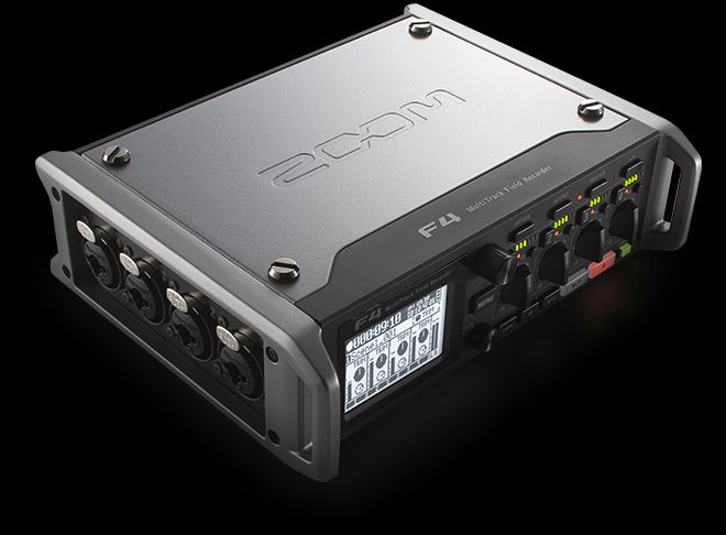

Zoom F4 with six inputs and eight tracks (is like a new low priced F8!)
    My blog post on this news: http://ironfilm.co.nz/news-leak-zoom-f4-with-six-inputs-and-eight-tracks-is-like-a-new-low-priced-zoom-f8/ (some of it repeated below)
    I thought the Zoom F8 when it was announced was a groundbreaking new recorder in what it brought to a new low price point for soundies.
    Now the F4 is even cheaper ($650 vs $1K), and has nearly everything the F8 has! Except for most notably the lack of extra XLR inputs (8 vs 4, thus the names: F8 vs F4. The "F" = field recorder, "H" = handheld recorder such as H1/H4n/H5/H6) and the lack of an app for the F4 to mix on a tablet like you can with the F8. Oh, and in a more minor point the F4 has a monochrome screen vs the 4 color screen of the F8.
    But everything else (such as pre amps, and time code) is basically exactly the same as the F8!

    Designed to provide big Hollywood sound on an affordable indie budget, Zoom F4 is a 6-input / 8-track professional field recorder featuring super-low-noise preamps and timecode with pinpoint accuracy. The unit provides recording and playback resolutions up to 24-bit/192 kHz with impressive audio specs including an extremely low noise floor (-127 dBu EIN) and high gain (up to +75 dB), with +4 dB line-level inputs. The on-board temperature-compensated crystal oscillator (TCXO) generates timecode at 0.2 ppm accuracy and supports all standard drop-frame and non-drop formats, as well as jam sync for external devices.
    The advanced on-board limiters provide overload protection for all inputs and outputs, which lets you capture audio in a wide range of environments. Limiting can be applied simultaneously at full resolution with 10 dB of headroom and features controls for setting threshold, attack, and release.

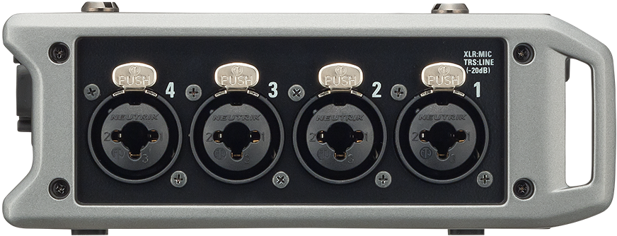

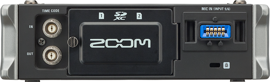

    The F4 offers four combo XLR-1/4" inputs, a 1/8" stereo input, and includes a Zoom mic-capsule input for recording six discrete tracks with an additional stereo mix, all at full 24-bit/192 kHz resolution. Additionally, inputs 5/6 can function as a camera return for audio monitoring only for confidence checks. The dual-SD card slot features simultaneous recording to both cards allowing you to make a backup or split recording with all eight tracks on one card and a stereo mix on the other. Each of the four XLR-1/4" inputs offers a dedicated preamp with gain control, phantom power, a six-segment LED level meter, plus a Record Ready and PFL switch. In addition to the 1/4" headphone output with a dedicated volume control, the F4 provides two main balanced XLR outputs, as well as two sub outs on a single unbalanced 1/8" stereo mini-jack, enabling easy connection to a camera. All timecode I/O is provided on BNC connectors and the unit includes a variable-frequency slate-tone generator to confirm levels.
    An easy-to-read 1.9" LCD display is suitable for use in all lighting environments including dark low-light sets to bright sunlight. The on-board mixer not only provides user-adjustable level, pan, and input/output delay, but also offers high-pass filtering for noise and wind reduction, phase inversion, and Mid-Side decoding. The F4 ships with a camera-mount adapter, AC power adapter, and download codes for Cubase LE and Wavelab LE.

    • Six discrete inputs, including four with locking Neutrik XLR/TRS combo connectors, a stereo 3.5mm input, and Zoom mic-capsule input

    • Accurate timecode (0.2 ppm) I/O on standard BNC connectors; dropframe/non-drop formats with Jam Sync

    • Dedicated gain control knob, 6-segment LED level meter, and PFL/Solo switch for each channel
    • Phantom power (+48V/+24V) on every preamp

    • Dual SD/SDHC/SDXC card slots, up to 512GB each
