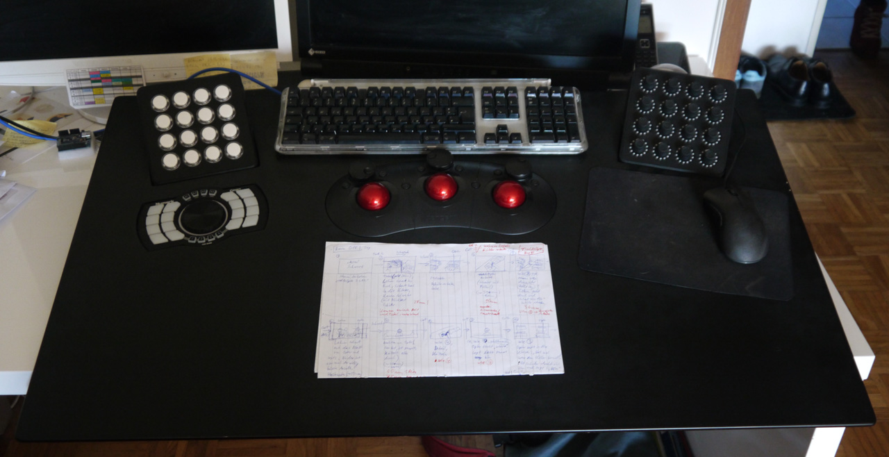

    As you can see in the pictures, I'm going to use the Ripple (3 trackballs) with a Midifighter Twister (16 programmable rotary encoders) and an Icon Istage (lots of buttons) for my colour grading setup. The Ripple does work out of the box. The Twister works really nice with Controllermate and I'm nearly finished with the program to control a lot of functions in Resolve with it. The Istage might be replaced soon, as the hardware is quite nice for the low price, but the software/firmware is total crap... really, its the worst I have ever seen. I will try a Korg Nanopad2 soon, hopefully this will work better.

    (I will make an extra tabletop where all controllers fit in slots to make them even in hight (especially the Twister is way to high to operate comfortalble while sitting), so the Ripple will stay in place anyway.)

  • So, the hardware side is finished (cables and USB-hub are built in on the backside of the panel):
