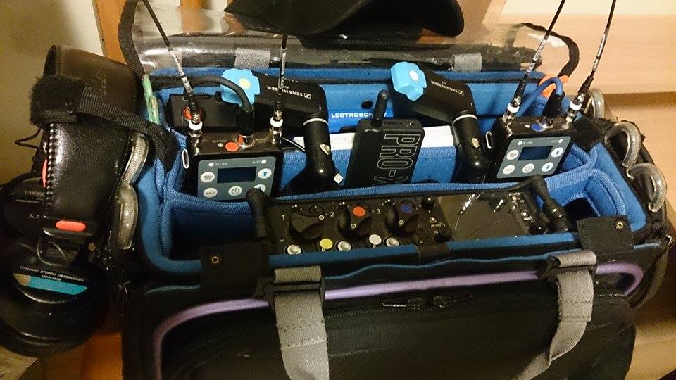

Even serious pros have an Azden PRO-XD in their bag :-o But just as a camera hop.
http://jwsoundgroup.net/index.php?/topic/10386-show-me-your-bag/&page=52#comment-305471
