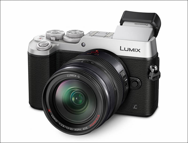

    • 20 Megapixel sensor
    • Dual IS (on sensor and on lens working together)
    • 1/16000 sec High Shutter Speed using Electronic Shutter
    • 2.36 million dot organic EL tilting EVF
    • 21mm Eyepoint LVF for improved usability with glasses
    • Dust and water resistant
    • magnesium alloy body
    • 4K Photo
    • 4K Video
    • Focus Peaking
    • 2.5mm Microphone Socket
    • Silent Mode
    • Free Angle 1.04 million dot organic EL monitor
    • Wi-Fi, NFC, QR code connection
    • Continuous shooting 8 frames / sec in the AF tracking
    • Time Lapse Shot / Stop Motion Animation
    • Body color is black and silver
    • Very good prices for kits on deals - http://www.personal-view.com/deals/cameras/panasonic#panasonic-gx8

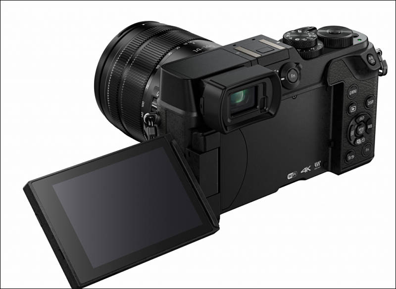

    My lordy lord. Best compact for m43 user ever made? Seems like it. There's no audio jack but who actually cares about that on a camera of this size for its intents and purposes.
