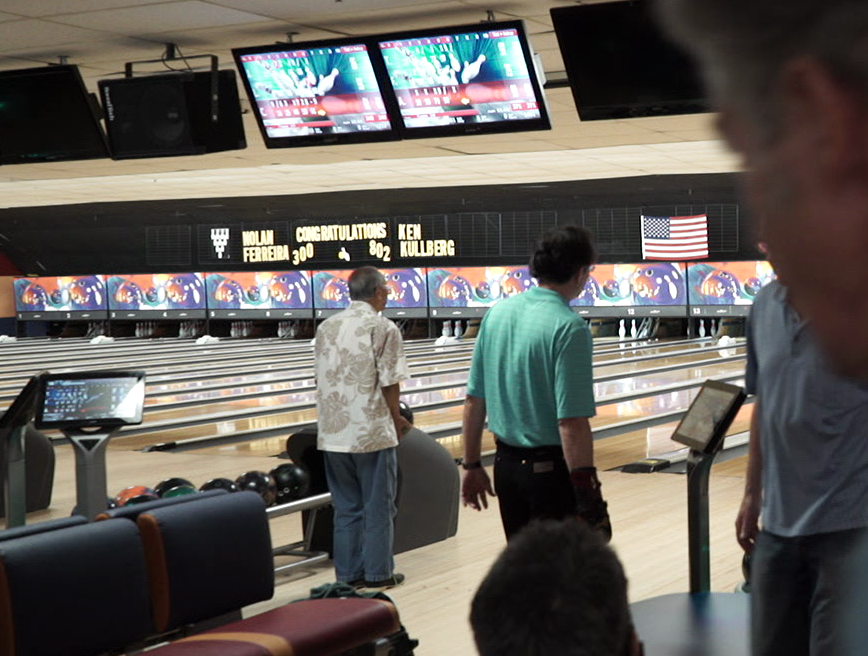

  • Balazer, I do not even want to remember those settings. But low light, small aperture opening, and fast shutter speed are the main reasons for such poor images although I did expect better results from the A7s.image

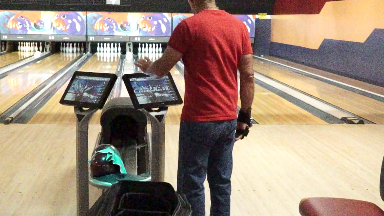

  • As you can see, the second try was much better/more usable.image

  • Curious as to why you felt you wanted to return the camera after the first shoot?
  • @mrbill , based on the first image it is clear why... he doesn't know how to operate it!
  • IronFilm, You are correct but unfair. The first attempt was out of the box with nearly default settings! (maybe not default settings but the ones the camera came with) Only changes were a perceived necessary higher f-stop for more DOF and higher shutter speed to stop action.
    As for why I wanted to return the A7s, the results were unacceptable. Even the second try was not as good as when using my GH4 the first time (out of the box, but after owning a GH3).
  • Were you in S-Log with a high ISO?
  • That is your issue, selecting higher f-stops! And even worse, high shutter speeds too!
