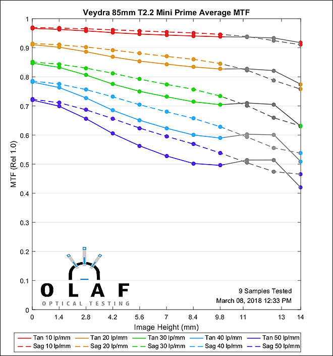

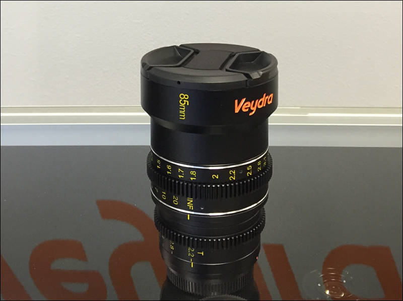

85mm performs just like the other Veydras, so much so it’s downright boring. And that’s a good thing.
The lens captures a crisp, contrasty image with no noticeable lateral chromatic aberration. The image is flat as a pancake: I couldn’t see any distortion at all, not so much as a single pixel’s deviation in a straight line running along the edge of the picture.
The sweet spot for the 85mm is from T2.8 to T5.6, where its images are razor-sharp. At T2.2 the image is softer, if only slightly; as you close it down to T8 and below diffraction takes its toll.

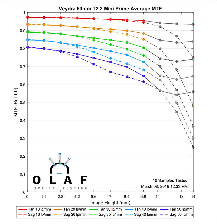

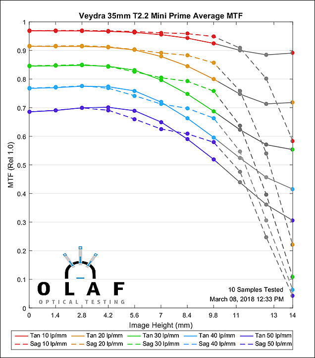

Veydra’s lenses definitely score higher than the competition for build and professional features. Optically, in the main, the lenses live up to expectations. All but the 25mm are a little soft wide open, with the 50mm and the 12mm the worst offenders. The 25mm is remarkably good at T2.2 – it’s center resolution only starts to fall off with diffraction at smaller apertures. The other lenses all peak in performance around T5.6, with edges softer than center for the 25mm, 16mm and 12mm. These lenses have image circles that only cover the Four Thirds sensor, whilst the 50mm and 35mm will (just) cover S35. We took measurements on a MFT camera, so these edge results are not surprising. Diffraction limits the resolution of all these lenses on MFT cameras from T11.

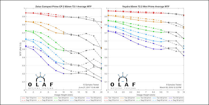

85mm T2.2 tests

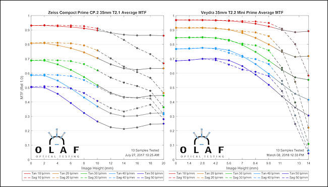

Comparison to Zeiss CP.2

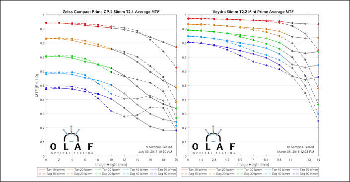

50mm T2.2 Lens Tests
