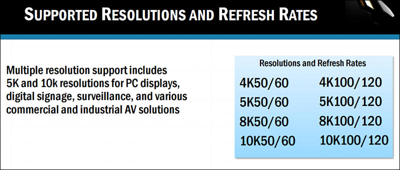

    HDMI Specification 2.1 Features Include:
    • Higher video resolutions support a range of high resolutions and faster refresh rates including 8K60Hz and 4K120Hz for immersive viewing and smooth fast-action detail. Resolutions up to 10K are also supported for commercial AV, and industrial and specialty usages.
    • Dynamic HDR support ensures every moment of a video is displayed at its ideal values for depth, detail, brightness, contrast and wider color gamuts—on a scene-by-scene or even a frame-byframe basis.
    • The Ultra High Speed HDMI Cable supports the 48G bandwidth for uncompressed HDMI 2.1 feature support. The cable also features very low EMI emission and is backwards compatible with earlier versions of the HDMI Specification and can be used with existing HDMI devices.
    • eARC simplifies connectivity, provides greater ease of use, and supports the most advanced audio formats and highest audio quality. It ensures full compatibility between audio devices and upcoming HDMI 2.1 products.
    • Enhanced refresh rate features ensure an added level of smooth and seamless motion and transitions for gaming, movies and video. They include:
      • Variable Refresh Rate (VRR) reduces or eliminates lag, stutter and frame tearing for more fluid and better detailed gameplay.
      • Quick Media Switching (QMS) for movies and video eliminates the delay that can result in blank screens before content is displayed.
      • Quick Frame Transport (QFT) reduces latency for smoother no-lag gaming, and real-time interactive virtual reality.
    • Auto Low Latency Mode (ALLM) allows the ideal latency setting to automatically be set allowing for smooth, lag-free and uninterrupted viewing and interactivity.

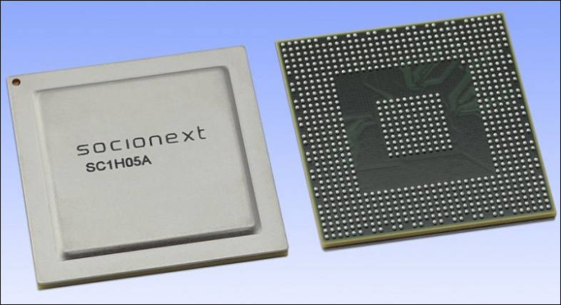

    Socionext just announced that its HV5 processor - the first in the world compatible with HDMI 2.1 - would not be available before March 2019. Obviously, several TV manufacturers should take advantage of CES in Las Vegas next January to unveil their HDMI 2.1 compliant models, but in fact, these should be available later in 2019.
    786 x 427 - 50K
  • But it is still delays
    “We are pushing to get a product ready as soon as possible. We’re particularly [anxious] to get this in front of the integrators, especially the integrators, in preparation for being future ready, because that’s what people want,” said Scott Kleinle, Legrand product management director. “We don’t have a scenario here like a smartphone, where you get a new one every six months. That’s not acceptable when you are spending the kind of money [that people putting in custom home theater systems] are spending. For people who are putting in a home theater this year, [we say] as soon as the product is ready… we are already getting inquiries. If you are an integrator, an installer or a builder, you are looking at product availability and we are already getting those questions.”
    “For someone buying an 8K TV now there is no way of getting an 8K signal into it. So I am curious about that as well,” said David Meyer, CEDIA technical content director.
    https://hdguru.com/hdmi-2-1-slowly-moves-into-the-market/

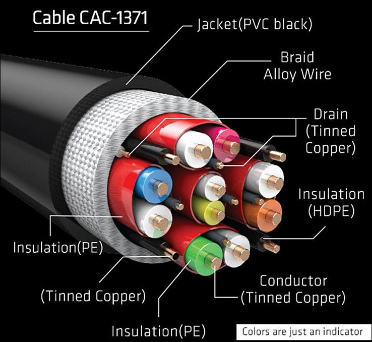

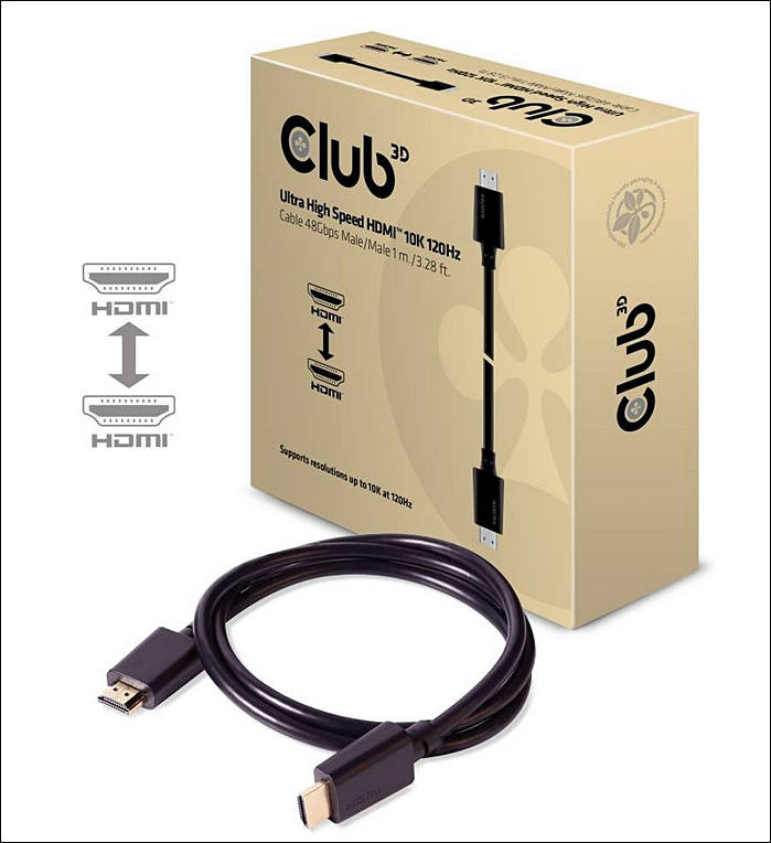

  • First new cables by Club 3D
    699 x 764 - 57K
    738 x 678 - 73K

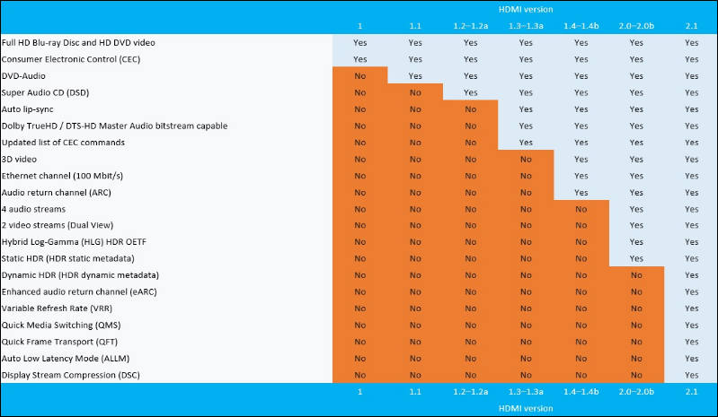

  • Nice breakdown
  • 2019 Samsung and LG TV Supported HDMI 2.1 Features By Model Series:
    High Frame Rate Video
    High Frame Rate (HFR) capability  will allow high resolution video signals at higher than 24 and 30 fps rates. The new faster frame rates like 4K/120 fps and 8K/60p should enable sending live high-resolution video of fast-action sporting events in crystal clear, smooth motion resolution with minimal pixelization and blurring.
    Samsung TVs
    Samsung TV models in the 8K Q900R series will support 8K video at a HFR of up to 60 fps through HDMI 2.1 connections. Those who bought a Samsung 8K Q900 last year, will be able to get a complimentary upgrade of a board in the set's OneConnect Box (installed professionally) to accommodate 8K HFR over HDMI 2.1, Samsung said.
    In 2019, only the 4K Q90 and the 8K Q900R QLED TV series will support High Frame Rate (HFR) 4K Ultra HD video (4K/120 fps) in 2019. Models in the Q60, Q70, Q80, Q90 and Q900 series and the 9500, 9000 and 8600 Series NanoCell TVs will also be able to do HFR 120 fps at 2K and 2.5K resolution (2K/120 fps, 2.5K/120 fps).
    LG TVs
    LG OLED TV models in the W9, E9, C9 Series and LG NanoCell LED-LCD TVs in 9500 and 9000 Series will support 4K HFR over both HDMI 2.1 and USB inputs. Models in the NanoCell 8600 Series will support HFR only through USB input. This is to be added via a forthcoming firmware update.
    Variable Refresh Rate (VRR) is a standardized system for TVs to synchronize the display with a gaming console or PC. Xbox One S and One X were the first devices to support VRR over HDMI.
    Samsung TVs
    All Samsung QLED TV series (Q60, Q70, Q80, Q90 and Q900R and the RU8000 Series edge-lit 4K LED-LCD TV Series will support both VRR and AMD's proprietary FreeSync (a system like VRR that maintains perfect synchronization between the display and a PC or console even as a game's frame rate fluctuates) at up at up to 120Hz. FreeSync is supported by Xbox One S and One X consoles.
    LG TVs
    LG's W9 Series 4K OLED TV series will not support VRR neither will 8600 Series LG NanoCell TV models nor 9000 other than the 65 and 55 inch screen sizes, which will.
    ALLM
    Auto Low Latency Mode (ALLM) is an HDMI feature specified in version HDMI 2.1 that allows a gaming console such as the XBox One S or XBox One X automatically control all connected compatible components in an HDMI chain, including an AV receiver and TV set, to enter a game mode or low-latency mode without requiring the user manually go into the TV settings to make the change.
    Samsung TVs
    Samsung supports ALLM through HDMI on all of its mid-level and higher-end 4K Ultra HD television series including all 2019 QLED TVs as well as the RU7 and RU8 Series 4K edge-lit LED-LCD TVs.
    LG TVs
    LG supports ALLM through HDMI on all of its 2019 4K OLED TV and 2019 4K NanoCell TV Series models.
    Dynamic HDR Metadata (SMPTE 2094)
    Dynamic HDR Metadata are instructions carried through number of HDR profiles (Dolby Vision, HDR-10+ etc.) transmitted by a source component to a supporting television telling the display how to present brightness, contrast and color levels on a scene-by-scene or frame-by-frame basis to produce varying levels of high dynamic range through out the course of movie or program.
    Samsung
    All 2019 Samsung QLED TVs and RU8 Series 4K Ultra HDTVs support Dynamic Metadata via HDMI for the HDR10+ profile.
    LG
    All 2019 LG 4K OLED TVs and 2019 4K NanoCell LED-LCD TVs support Dynamic HDR Metadata via HDMI for the Dolby Vision HDR profile.
