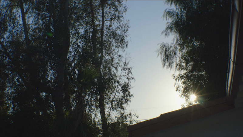

SOLID and LIMIT V-log Interpretation LUTs are now available for download and testing on the Pro Users page.
SOLID is just what the name implies. A very solid true interpretation, placing middle gray at around 45 and retaining the full spectrum of color.
LIMIT moves middle gray up closer to 50, and clamps the highlights. You may notice some chroma blocking using this one on gradient skies with wide DR, but on everything else. It should work fine.
These may not work under Premiere Pro and Speedgrade yet. Tested in Resolve and AE, and FCP-X.

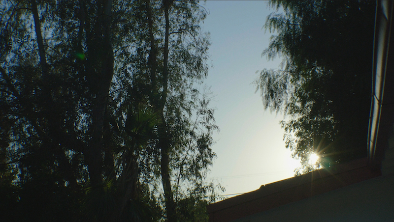

Remember the GH2's infamous "green shift" that would be baked into the footage, and we all wondered why the footage came in that way? Well, it looks like it was all part of the color science that made the GH2 so awesome. And it's back with V-log.
After spending time with the Alexa curve which is almost identical to the V-log curve but gives it that oh so familiar green tinge to the image. I think I discovered why that tinge was there in the GH2. This interpretation helps greatly mask the blocking. So now the trick is eliminating the green without the blocks jumping out, and without darkening the image.
Luckily for you guys the Minus Green and Green Kill LUTs work perfectly in this capacity just as they did with the GH2.
ALEXA C-log
EASY which is my own take on Alexa's curve but with Minus green applied and a very very subtle mid boost.
Using C-log and adding GreenKill or Minus green will give you similar results only without the gentle mid boost.
