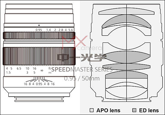

The limiting f/# for a lens in air meeting the Abbe sine condition (i.e., corrected for spherical aberration and coma) is f/0.5. At this point the marginal rays are perpendicular to the optical axis, or parallel to the image plane, so its a pretty obvious limit in some ways.
f/0.55 (i.e., NA = 0.91) is not completely unheard of. There are some extremely high-power microscope objectives designed to work in air (i.e., not oil immersion) that approach that value.
Regarding Speed Boosters, the 0.58x BMPCC Speed Booster is designed to produce f/0.74 when used with an f/1.2 lens (more accurately f/1.2599). The limit of f/0.74 is set by the clear aperture of the first few lens elements in the Speed Booster. If you attached a lens faster than f/1.2599 you would still only get f/0.74 out of the lens + Speed Booster system.
As far as I am aware, f/0.74 via the 0.58x BMPCC SB is the fastest lens you can buy today. There are a handful of lenses in the history of photographic optics that have been faster than that, the Zeiss 50mm f/0.7 being the most famous example.

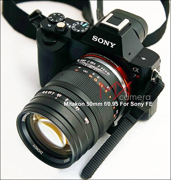

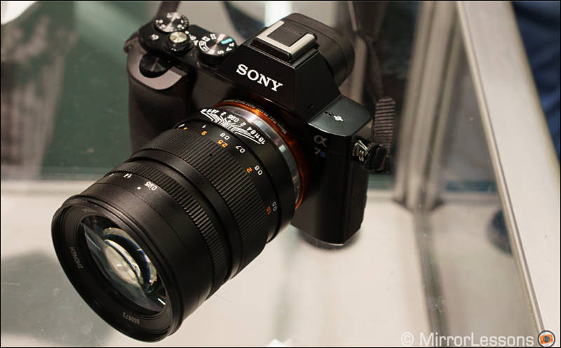

Just realized this can't possibly be a Nikon mount, since the F-mount is limited to f/1.2. If the lens does cover 24x36mm I assume its something like a Sony E mount.
From google translating the original link (http://newbbs.fengniao.com/3157237.html):
"...Not much to say, first loading, the fuselage is SONY A7, the entire 0.95 full aperture, shaking it, Cock wire them..."
There you have it. Sony E mount it appears. Cock wire them!
Must be available soon
Price: $799
Lens available now at http://www.ebay.com/itm/191164910491

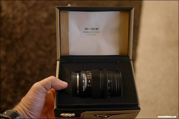

Hands on and some samples
Mitakon Dark Knight is a special purpose lens. It is not a general replacement for Zeiss 55mm. As such, decision to get one is not merely related to the price of the lens, but mainly to the aesthetic taste and type of photography. Only if one is very interested in super fast primes this review is even relevant.
The applications of a lens like this could could range from portraits to landscapes and night photography.
