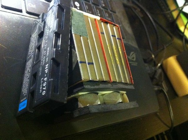

  • Cheap F970 batteries can be quite funny inside, you can try to disassembly yours. Sometimes chinese put metal bolts inside :-) and small F550 like battery.

  • Some of the batteries have surprises:
    604 x 451 - 62K
