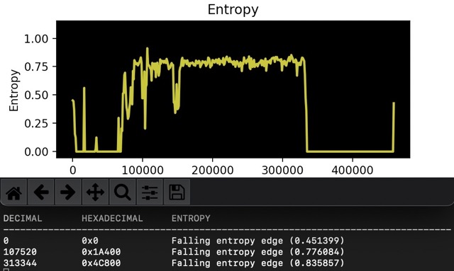

  • UPDATE: Initially I thought the firmware might be encrypted but looking at the entropy it seems it is not but I cannot find any signatures so not sure how to unpack it.

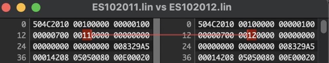

    I have compared two versions of the firmware and found at least two hex values that are references to the version number.

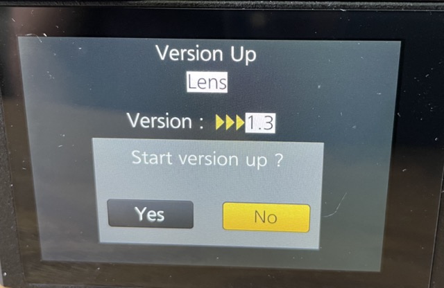

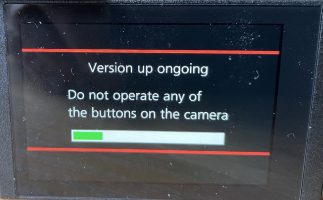

    Changing the first value is enough for the camera to read a new version and launch the firmware update process but it freezes around 1/5th of the way.
    image image
    After pulling the battery from the camera the lens is still working and recognised with the old version as before.
    640 x 383 - 48K
    640 x 124 - 36K
    640 x 416 - 48K
    640 x 397 - 58K
