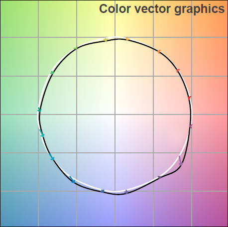

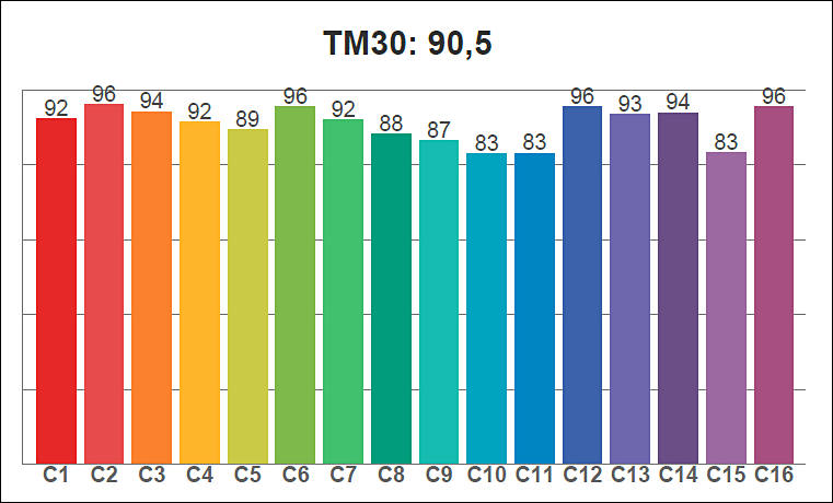

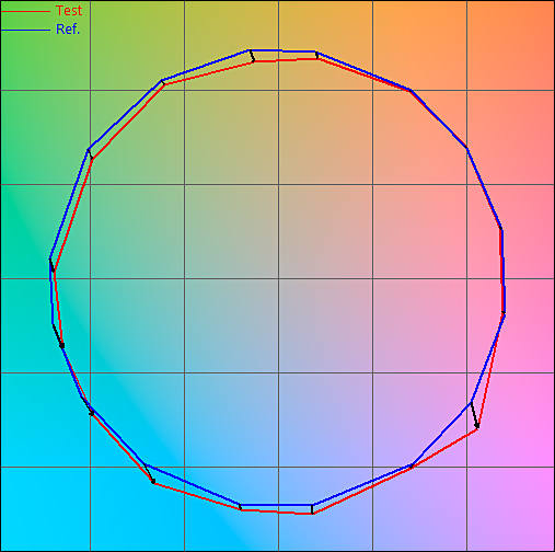

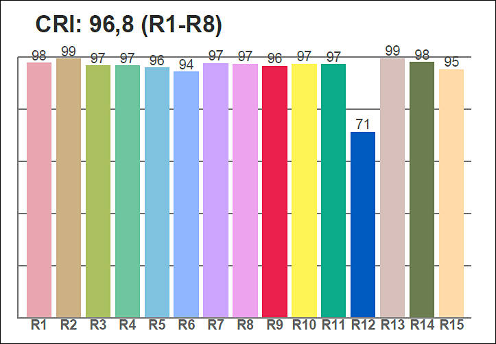

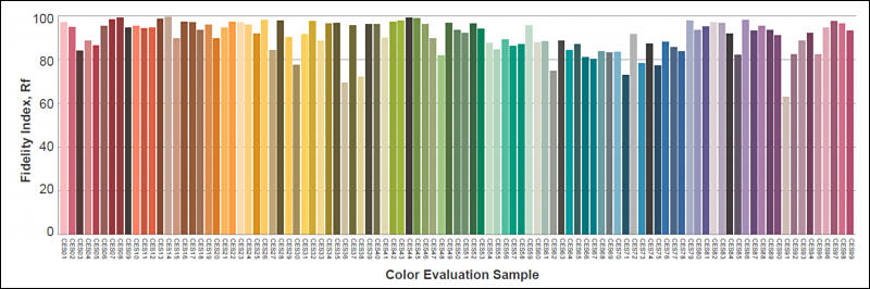

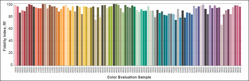

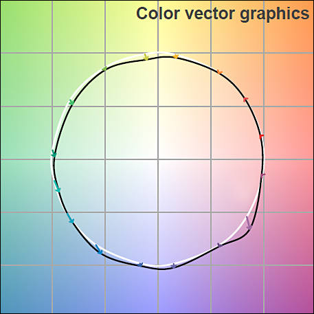

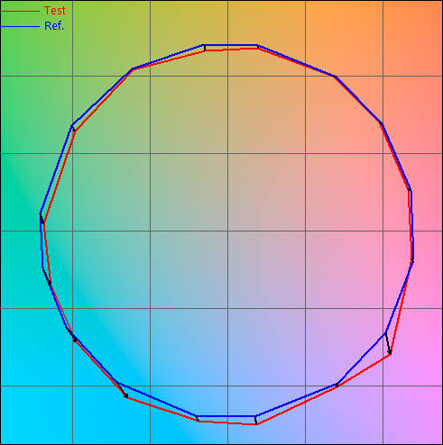

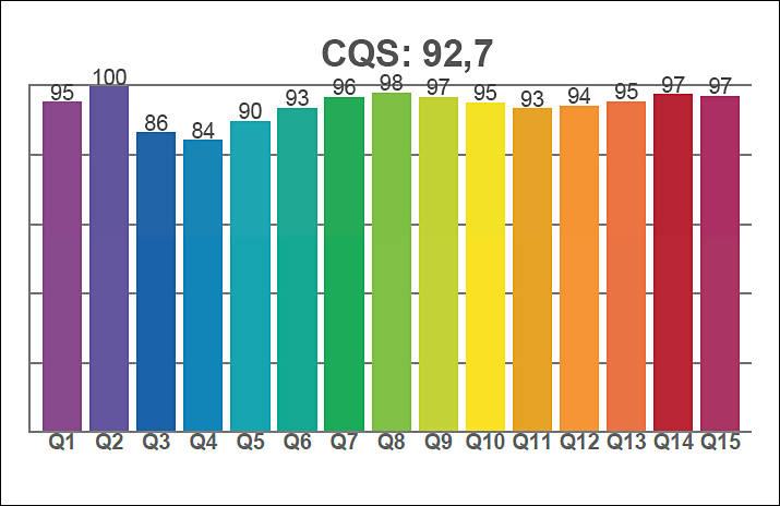

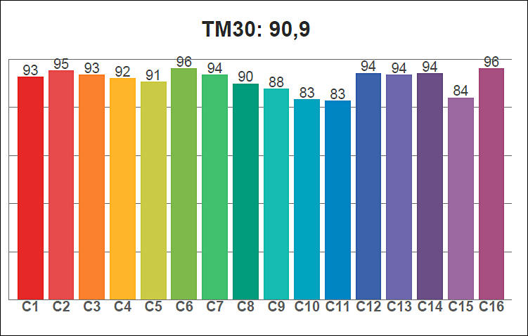

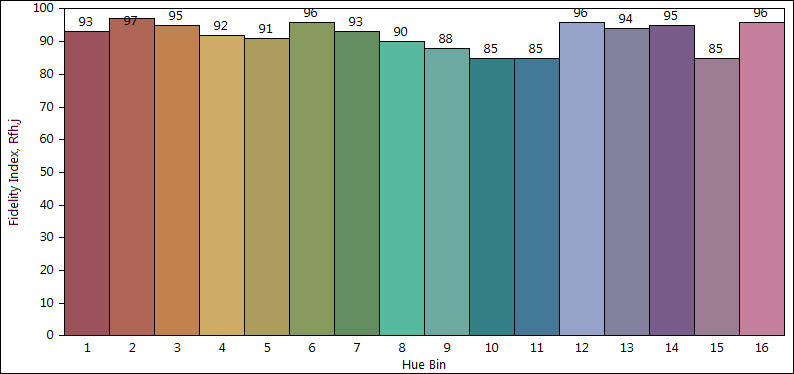

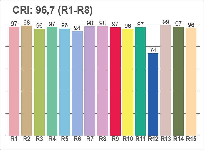

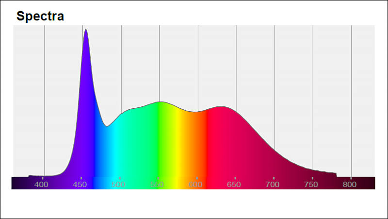

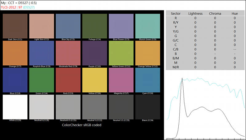

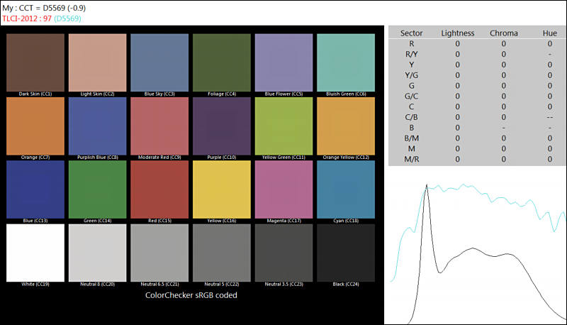

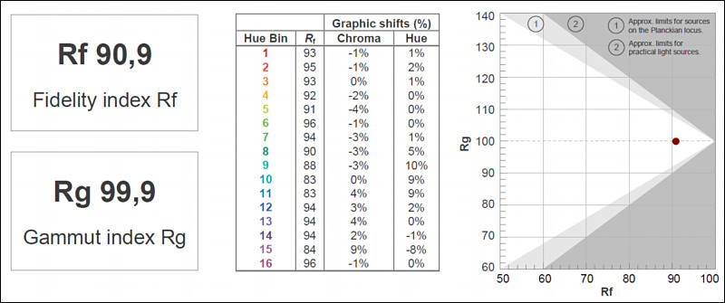

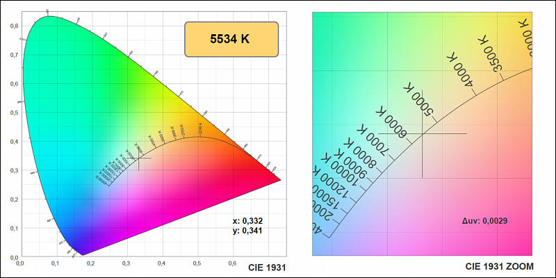

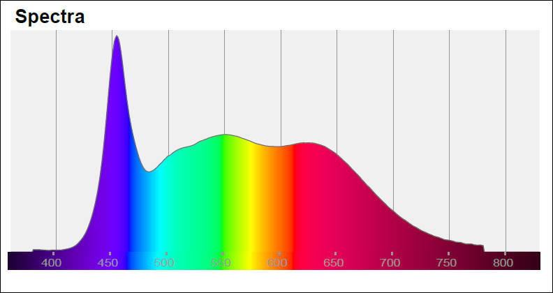

  • Godox S30 (Daylight model), Measurement using CV600, Russian Lab processing
    Focus on TM30 and CIE 224 and look for color distortion and Rf values.
    S30 is very good light with light quality suitable for videos.
    Color temperature
    CRI color quality
    CQS color quality
    TLCI 2012
    TM30 color quality
    TM30 details
    CIE 224 2017

  • @Vitaliy_Kiselev when we see such good numbers and with an expected low price we begin to surch for the catch ;o)
  • @Cid
    Numbers are quite typical for good photo/video lights. It uses same quality led as Aputure and similar lights.
    Absolute top led numbers are 98.5-99.8 :-) And no blue peak you can see here.

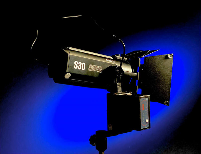

  • When I saw the light I did not hear any fan. I was impressed with this little light. I use the Godox 60W in my studio.
  • Review coming

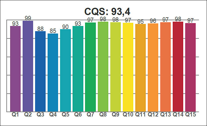

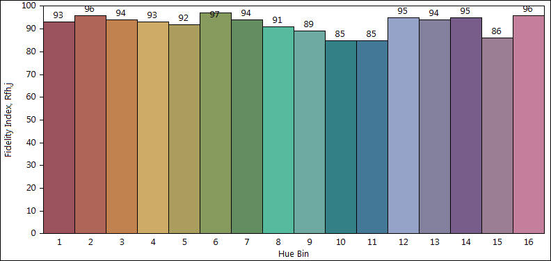

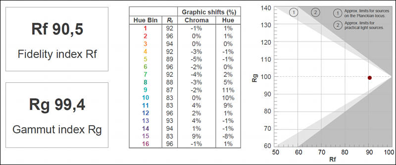

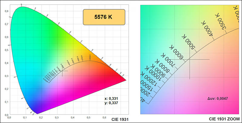

  • Godox S30 (Review unit, Daylight), Measurement using CV600, Russian Lab processing
    Color temperature
    CRI color quality
    CQS color quality
    TLCI 2012
    TM30 color quality
    TM30 details
    CIE 224 2017
