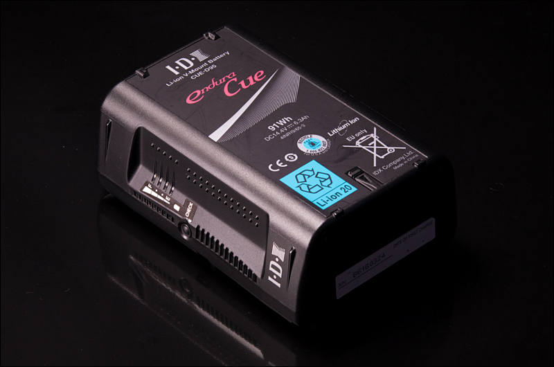

PV Lab: IDX Endura Cue V-Mount battery test
  • Simple sample of our battery tests
    Manufacturer specs
    • 91Wh capacity
    • 620g
    • 25.4mm depth
    • 12V cutoff voltage

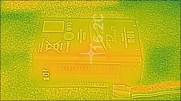

    Thermal behavior
    Start
    Depleted battery

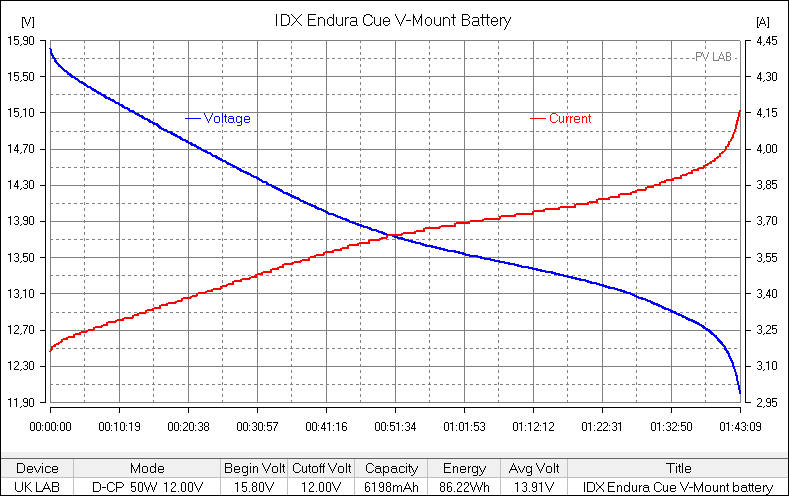

  • V-Mount battery, UK Lab, discharge from fully charged state, 50W constant load
    Consumption close to URSA Mini Pro + EVF in recording mode.

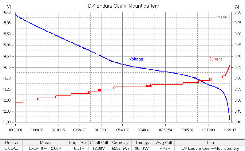

  • V-Mount battery, UK Lab, discharge from fully charged state, 8W constant load
    Consumption close to GH5 in 4K 60fps recording mode or Canon 7D DSLR in video recording.
    797 x 492 - 94K
  • Tests conclusion
    Battery thermal behavior - perfect
    Capacity
    • 50W load - perfect
    • 20W - perfect
    • 8W - perfect
    Very good battery with capacity fully matching real usage scenarios.
