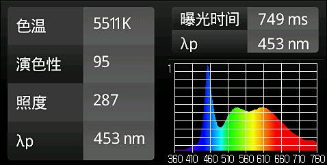

It actually depends on panel, as such thing as 50-50% exist mostly in your mind as usually good mix require more bright warm leds (as their output per watt is lower).
Anyway, ideal does not exist in this world.
It is just better to shoot with best that exist (such this lights made by special order).

312 it about 17-18Wt, 1024 around 65-70Wt.
