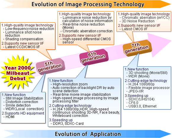

  • Two most advanced camera LSI manufacturers are Panasonic and Fujitsu.
    So, it is interesting to look at some plans (as new LSI will be used in 2012 and 2013 cameras):
    As you can see main topics are movies and 3D. Including wide dynamic range movies recording.
    1080p50/p60 recording will be standard feature for both companies.
    As well as UHS cards support (read - much better write speed) and USB 3.0 support (read - ability for video streaming).

  • Where did this chart come from?
    Is there any additional information on the wide dynamic range movie capability? Presumably this is new sensors with more bits per pixel - but does this imply improved image processing but still stuck within AVCHD/MJPEG boundaries, or is their a raw-type mode coming?

    Fujitsu still does not have LSI with 60p encoder :-(
  • The new chip comes equipped with a widely-used H.264/AVC video compression algorithm from Fujitsu Laboratories. As a result, MB86S22AA can compress and decompress full-HD 30p and 60i video
    First camera that uses this chip is Pentax K-3.
    As you can see, all chip restrictions restrict camera. Especially its video modes.
    Also none of promised WDR or 1080p60 encoder found it's way to final chip.
    The only hope is USB 3.0 controller and ability to transfer raw via it.
