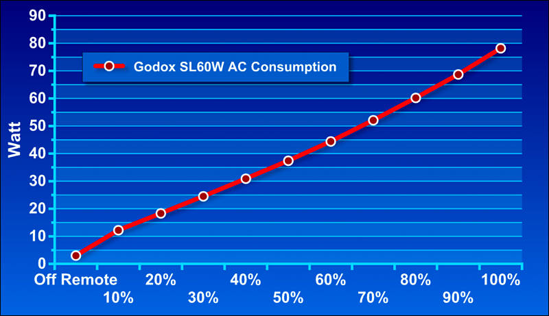

Thermal behavior
Initial quick test with fresnel attachment, US Lab.
1 minute run
20 minutes
Third party app
Godox SL60W (daylight version), 100% level, Measurement using CV600, Russian Lab processing
Second measure at full power.
Only indexes. All else see on top. With lowering level CRI drops slightly, TM30 almost same.

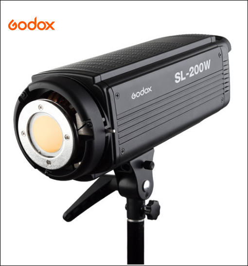

I have the SL-200W and SL-60W with me. My original intent was to try to save some $$$.
I was looking for a new key light I could use with Bowens mount octas and some back / rim lights.Right off the bat - fan noise. Unmodded it's very noticeable, like a medium-loud PC. I did some tests AFTER my fan mods in my bathroom and bedroom - about 1m away from either light you can still pick up the sound of the fan. In my opinion they're too loud to bring on the interviews, at least with the people I work with. I made some test recordings with a lav mic and hyper cardiod mic and I could hear the fans playing back with my Zoom H6 so I didn't even bother to playback on PC.
I replaced the stock fans with Noctua NF-A8 PWM series fans with the restrictor cables @ 1750rpm.
The SL-60W is pretty quiet but you can still pick it up. The SL-200W has two fans and they're quite noticeable. That being said, if you are using them in a "noisier" environment with other fans, computers, AC etc around, they don't add too much noise. I measured about 38db (33db ambient) for the SL-200W about 1m away (it's a $30 db meter so don't expect much accuracy). Due to the design of the units there's just nothing you can really do about the noise.
In terms of light output... well they're pretty decent but throw about 1/2 the stated lux. The SL-200W I measured at about 6 or 7,000 lux @ 1m. The SL-60W was about 2,000 lux. Not sure what the beam angle is, probably around 120 deg like the Aputure. I have no idea where the manufacturer stated lux measurements are coming from. With the reflector on, the SL-200W threw about 18,000lux @ 1m.
With the SL-200W and the Godox 47 and 32 inch octas and double diffusion, I measured about 2,500lux @ 1m. I made some diffusers out of frosted shower curtains instead and almost double the output @ 1m.
The surprising thing was the Nanguang NG-10X "fresnel" and the SL-60W did about 25,000lux @ 1m at spot (beating the Nanguang CN-60F, $140 vs $400!). The SL-200W only managed around 32,000lux @ 1m at spot - but the NG-10X feels like a toy.
Unfortunately I do not have a spectrometer so I can't comment on the actual quality of the light, but I do want to note that the lights I have are about 6,000K. To my eye they don't render skin tones as nice as the Nanguangs or Aputure stuff, but they also seem a bit magenta instead of green (my guess).
I really wish I did some noise tests before I separated the head from the SL-60W. I feel like it was just a whole bunch of wasted effort since I don't think I'll actually use these lights on any interviews. Live and learn.
