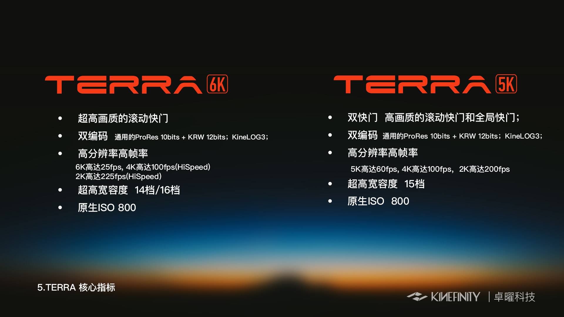

    • Terra 5K: 5K 60FPS, 4K 100FPS, 3K 150FPS, 2K 200FPS
    • Option of global shutter, native iso 800
    • 15 stops DR with rolling shutter and dual gain mode
    • 13 stops DR with global shutter

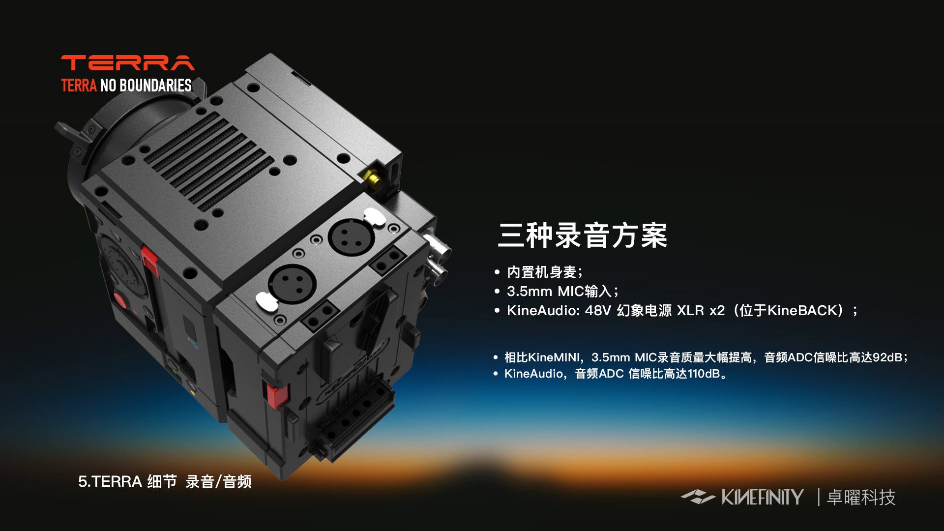

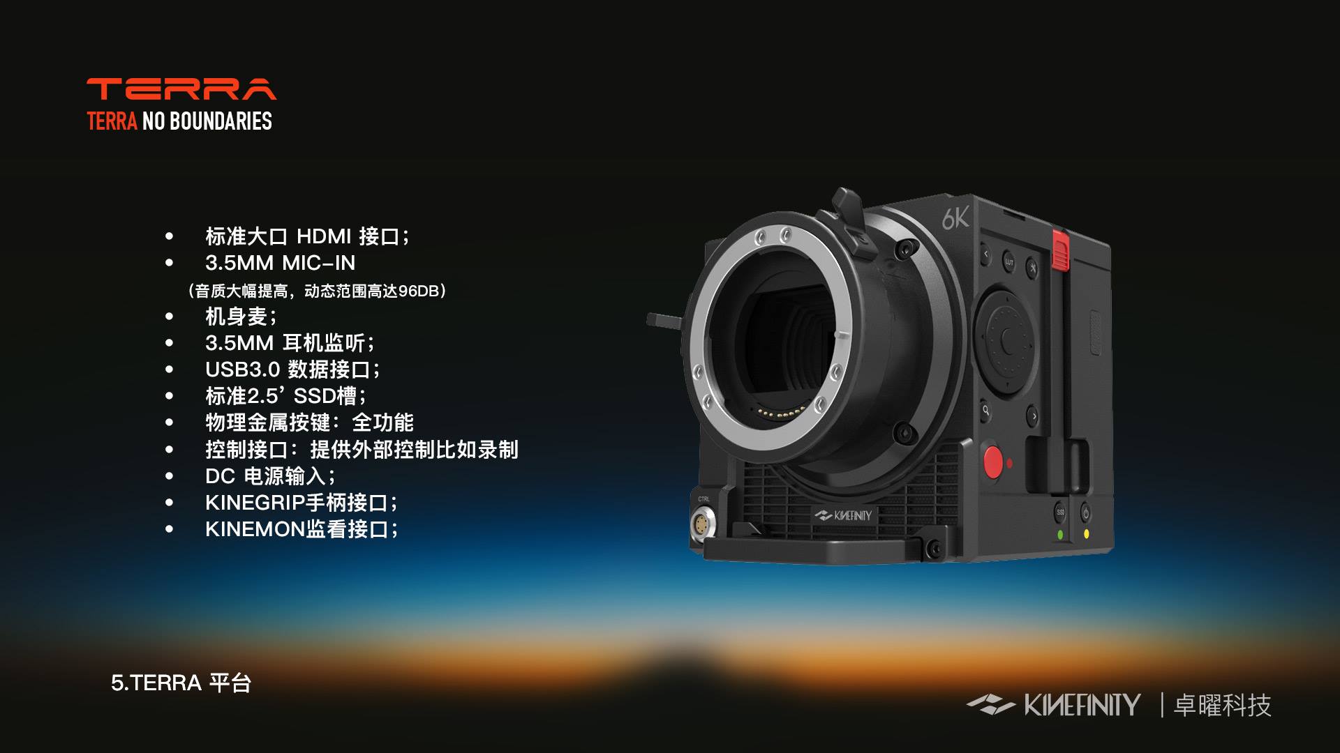

    • HDMI out with type A connector (big connector), 3.5mm Mic in

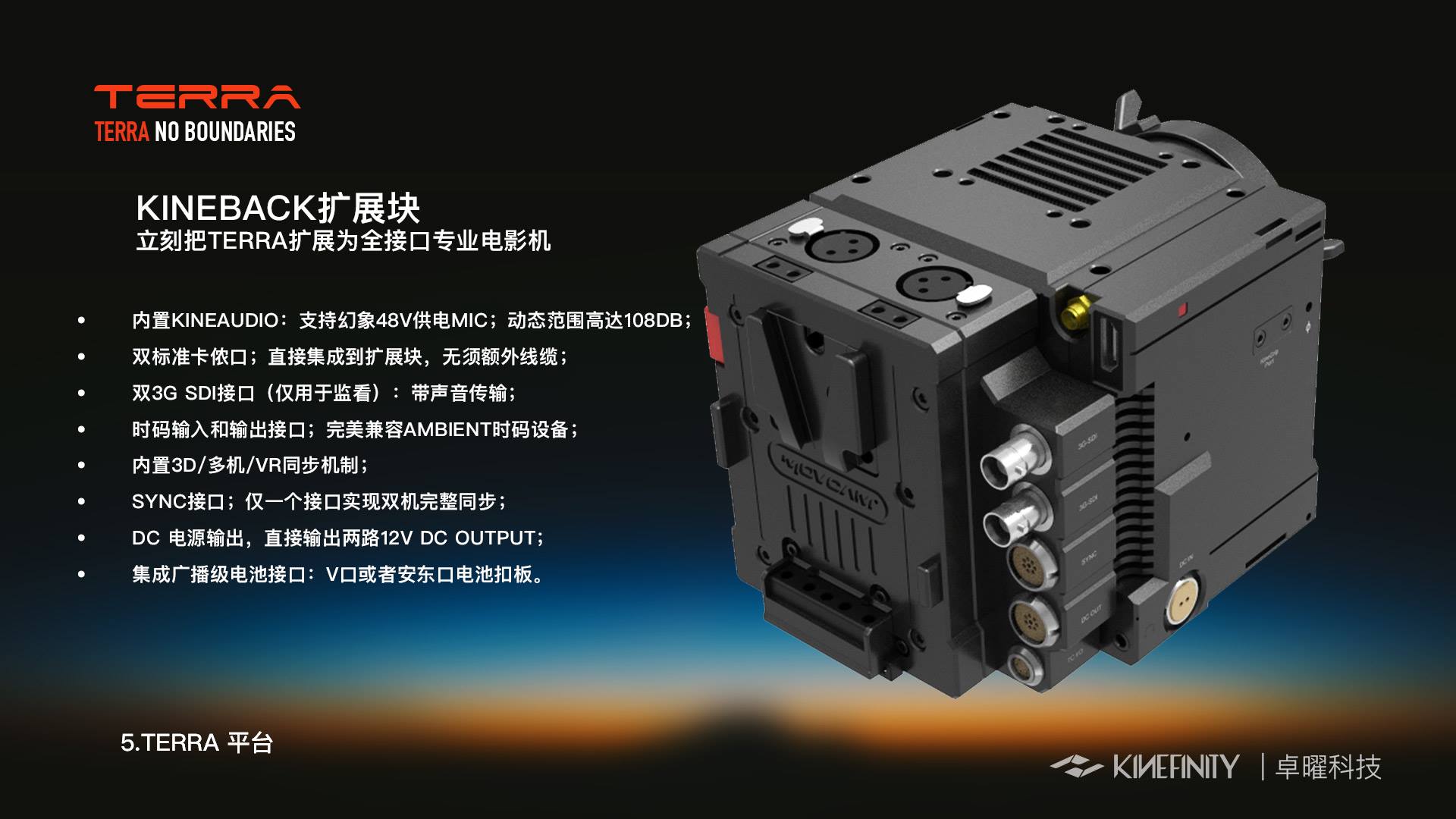

    • SDI and XLR are there as well.

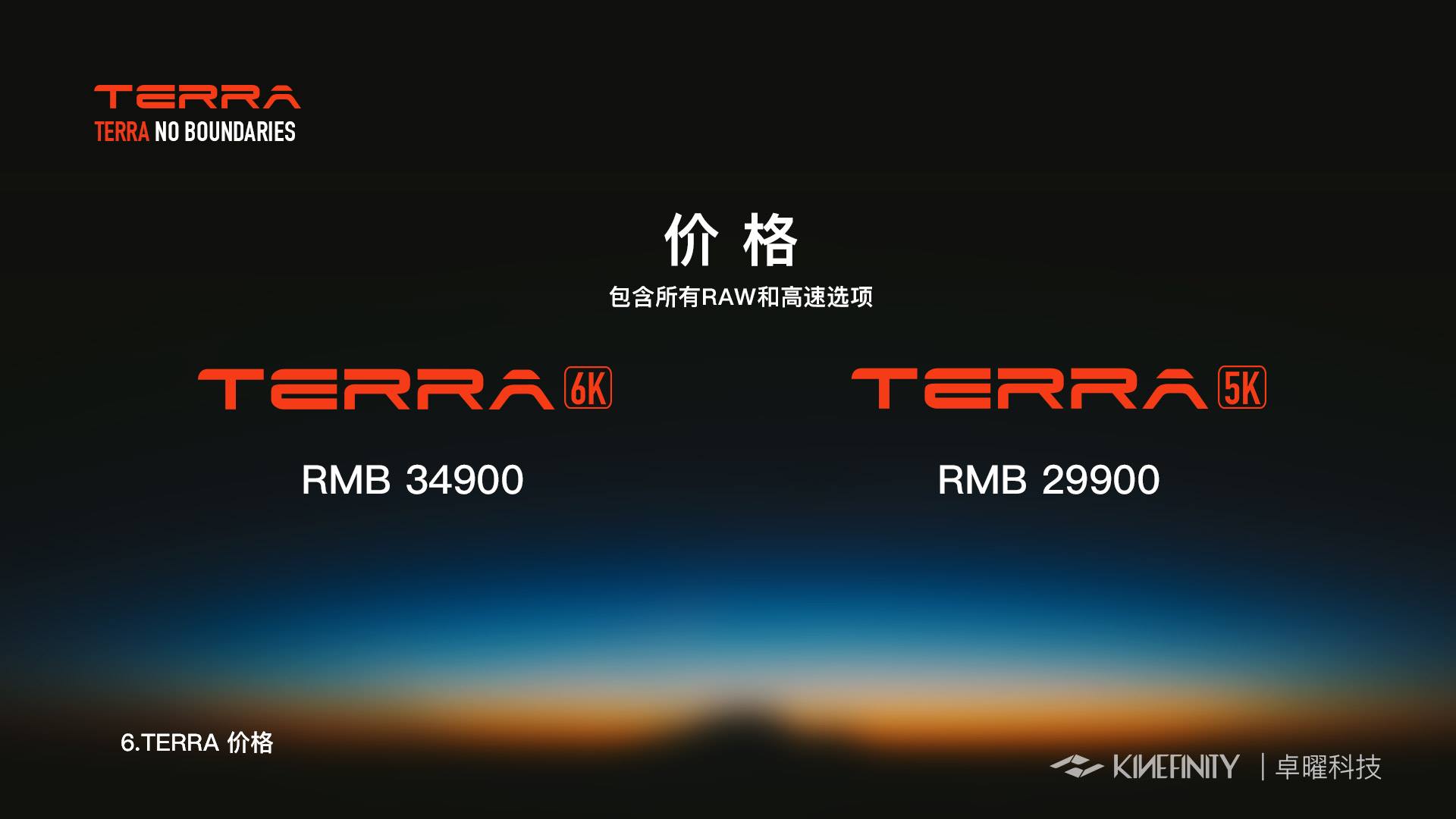

    • The 6K version costs slightly more (at around $5,400 US or 34,900 RMB on the Chinese mainland).
    • It features 6K at up to 25fps, 4K at up to 100 fps and 2K at 225fps.

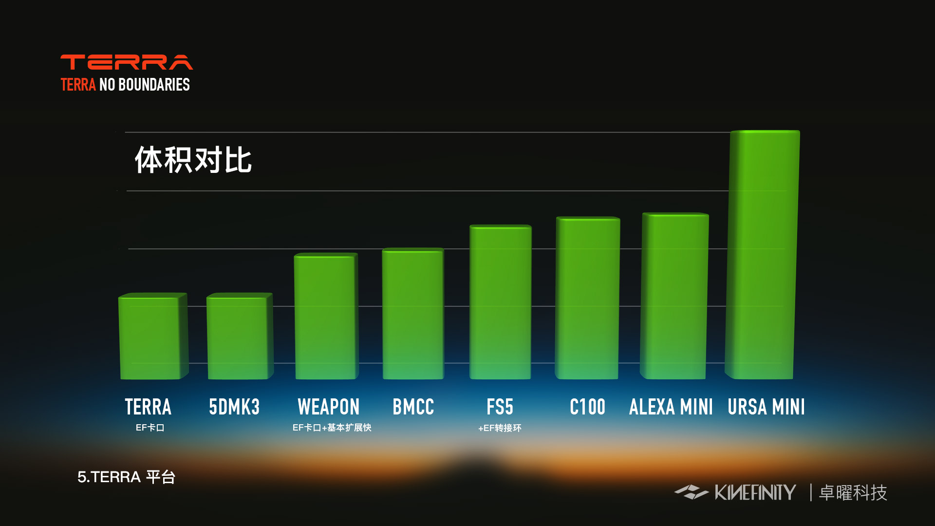

  • What is the chart with all of the various cameras showing? (the last picture)

  • @Xenocide38 close.... it is volume not weight.
