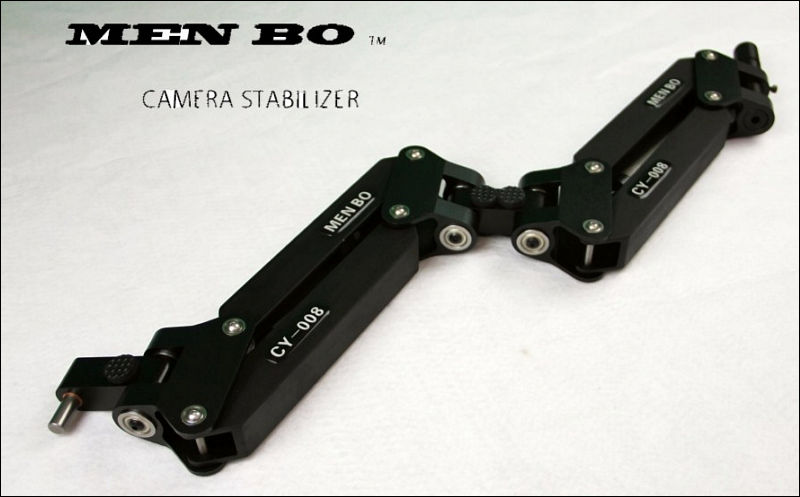

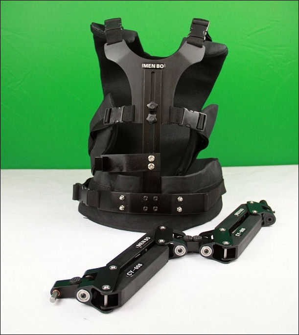

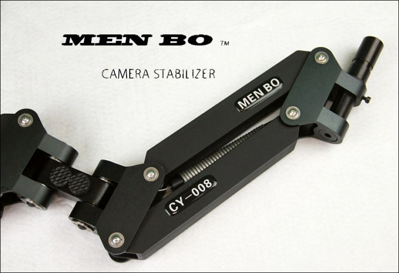

Men Bo CY-008
One of the cheapest offers (one on ebay that I found is $359+105)
http://www.ebay.com/itm/menbo-cy-008-steadicam-Stabilizer-Steadycam-CHRISTMAS-SALE-/290829509355
Did not find any really good words for it. It seems that it needs heavy modification and checking for good work.
