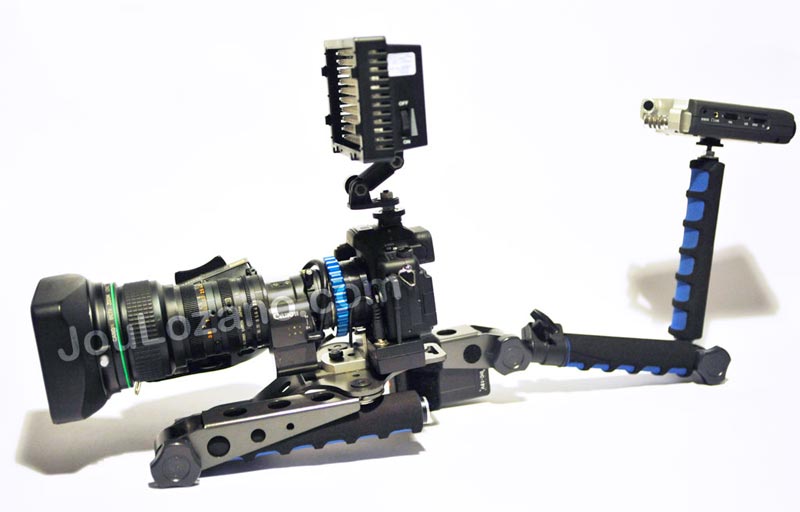

  • I use Canon B4 ENG lens on my GH2 with B4 -> FD -> M43 adapter. It's made for 2/3 inch sensors and it fills whole GH2 CCD correctly when I enable built-in 2x extender.
    It's somewhat soft when open fully wide, but it's plenty sharp when zoomed in, despite being built for Betacam SP.
    Rumors of "being built for three chip CCD's and thus unusable for single CCD" are untrue. Three chip or not, all ENG lenses have same chromatic focal point, thus will focus all colors in the same plane. Back-focus needs to be adjusted though.

  • Canon B4 on GH2 w/ ceico7 adapter.
