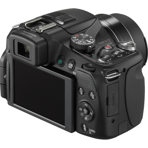

  • @jcmr Burst and stop. With the electronic shutter tyou can have also 40 or 60 fps. I buy it because i was searching for a zoom lens for GH2 and suddenly i see the new FZ200 with parfocal 2.8 !!! Bonus for me was the 100fps HighSpeed (question, there is nothing into the menu to change it to NTSC so i have 120fps?) and i found also that it has SUPERB macro and SUPERB stabilizer. The video quality is very good BUT it is NOT GH2 !!!! So, for me 600euros from amazon.de it is a bargain for all these features, PLUS Vitally wants to hack it!!!

    It is pretty good. Not as clean and sharp as my Canon M41, but very few cameras are. I do find myself using the LX7 indoors, where its f1.4 lens really makes a difference in noise, as I can use two stops lower ISO. The LX7 aperture ring is also pretty handy. However, the FZ200 is excellent for all-around performance, especially in well-lit scenes. Superb OIS, excellent focus, a very nice camera indeed.
  • @jcmr - Depends what you are wanting. FZ200 really is more like a handycam (e.g. Canon G10/XA10) in size, image quality and controls. I think the lens on the FZ200 is very nice and provides the range I wanted. But make sure your system can handle 60p and that your okay with not being able to shoot 24/25/30p or monitor audio.
  • @PatrickGF
    I do not agree about handycam here. Handycam is much more suitable for average Joe tasks and FZ200 is not really good for them, starting from handling to the focus, DOF, etc.
    Good advantage of FZ200 is wheel and buttons. Main disadvantage - lens, where Panasonic cut costs on all parts possible (noisy OIS, noisy and slow zoom).

    Mine has both OIS noise, and zoom hoise.
  • I've used it on a couple of weddings (just as a spare cam to play with) and I'm just not sure. how the hell do you use manual focus? I've switched the zoom rocker over to focus but that's next to useless. The OIS is great as is the zoom. The EVF is very average and I hate the offset mount on the bottom. you have to take the quick release off every time you change the battery.
    I've got some reasonable 100fps stuff that I'll use (maybe speed it up x 3 or 4 to give a slight slowmo) but I don't feel I could rely on it for a main camera.
  • I've switched the zoom rocker over to focus but that's next to useless
    Yep, not good :-) Useful only for slowly and carefully bring object into focus and fix it :-)
    Main thing here is that they found how to fuck perfectly normal construction, as even G1 viewfinder is not so tunnel and has not so much light leaks.
    This is ok, as you can't put it properly on cameras with such lenses.
    You can use some other smaller QR plate and some file help.

  • another wedding an another chance to give the FZ200 a run. I still haven't familiarised myself with all the settings but I'm starting to be really impresed. The OIS is stunning, I hate handheld and this doesn't look like hand held - it enabled me to move quickly and grab a shot of the signing when my view with a main camera was blocked. we picked of some guest shots during the evenng and in good light it's terrific (not sure how it will match in with the main footage but it should be okay). it does start to get noisy as the light drops but most of it still looks usable. I'm still frustrated by the lack of manual focus. the best I can do is switch the focus to manual and use the focus button - which works but.. (I'm old, I like a focus ring).

  • @jcmr - I uploaded two video files comparing zoom noise with internal and with Rode VMP. It's under zoom noise here https://www.dropbox.com/sh/tfr83z5xbe671sa/EsWJWtULJ1

    Thanks for the two videos. The zoom of your camera is very noisy. I haven't noticed that kind of noise on the videos I saw of the FZ200 on the net.
  • @jcmr
    His zoom is not very noisy, worst cameras exist :-)

  • The zoom on my US model FZ200 is audible, just like on the test clip from PatrickGF. Partly the problem is that the audio quality and sensitivity is so good to start with. It was tough for me to stop the sound of my breathing being picked up by the microphones. You can also hear the zoom with your ears, if the surroundings are quiet enough.
  • @trevmar
    During shooting FZ200 restrict zoom speed significantly, otherwise it'll be much much louder.
