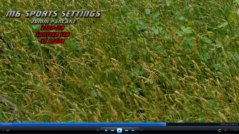

  • M6 Sports v.1.0h all gop2
    Scaling tables and deblocking are frome @Driftwood Canis Majoris Day pm
    Scaling tables for B-Frames are off.
    746 x 412 - 145K
    746 x 412 - 146K
    M6 Sports v.1.0h gop2.zip
    2K

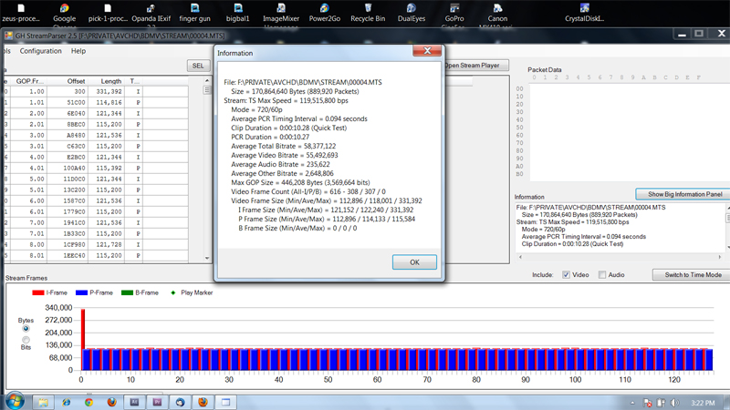

  • M6 sports Version 1.1 have a better p-frame quality.
    And follows the i-frame more, the bitrate is some lower, but the quality stays.
    746 x 412 - 165K
    746 x 412 - 173K
    746 x 412 - 171K
    M6 Sports (vbr) v1.1.zip
    256K
  • Looks like a nice patch :)
  • Mozes, what are the p frames like with motion in v 1.1 compared with Iframes? It looks an interesting patch, I'd like to compare this to Sanity 720p 50.
  • Depending on what you are shooting.
    But the goal is that it is still smooth, sadly enough 720 with only i-frames on a class 10 card what most off us have, is not reliable .
    The record time is between 10 seconds and 4 tot 6 minuts.
    I have included a pdf file how to set it to gop 1!! but only for pal, ntsc doesn't record more the 2 seconds ;(
    So i thought, why not gop 2 with 1 i and 1 p-frame,
    the settings before have a constant i frame with a variable p-frame.
    and one with constant p-frame and a variable i-frame
    Those settings give a higher bitrate, but a lower quality p frame.
    Visual you practically see no differences, but if you watch frame by frame, you will see it.
    Now with v1.1 where the p frame follows the quality from the i-frame, the bitrate drops, but the overall quality off the image is better.
    That will give better results if you do in post some slow motion with for example twixtor..
    In version 1.1 the i-frame keeps the quality stable ad a higher quality.
    And the p-frame will then be lower if there is for example a lot off "dark" shadow.
    The i frame and p frame will be also lower if its out off focus or with fast spanning.
    I only have a Olympus M.ZUIKO Digital ED 14-150mm f/4-5.6 lens.
    So i have no idea how it works with other lenses, and how the bitrates responds, on the Olympus 14-150 the bitrate increase when zooming in...
    By the way, in ETC mode the bitrate stays practically the same as without it... :)
