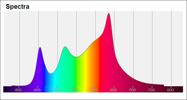

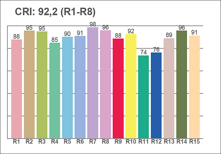

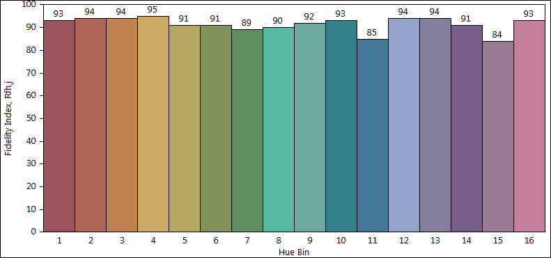

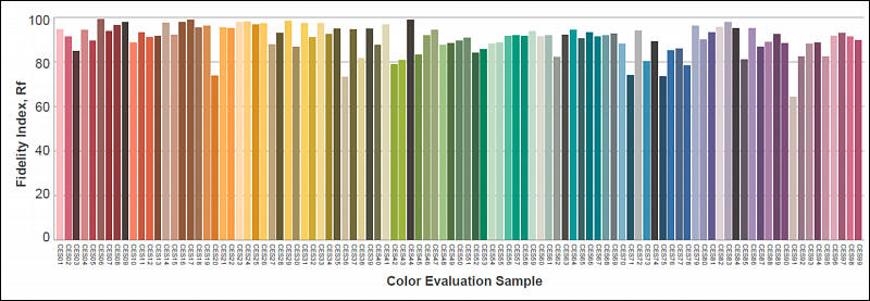

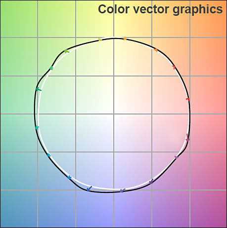

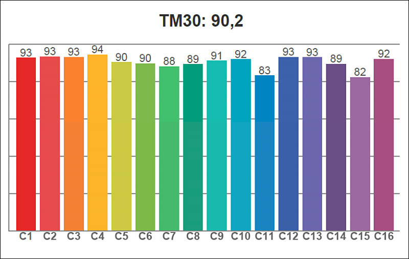

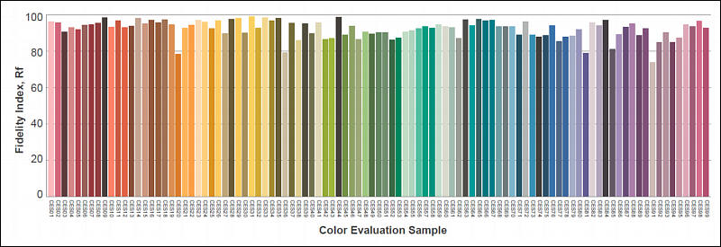

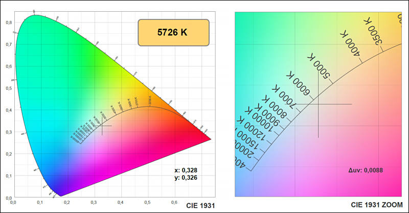

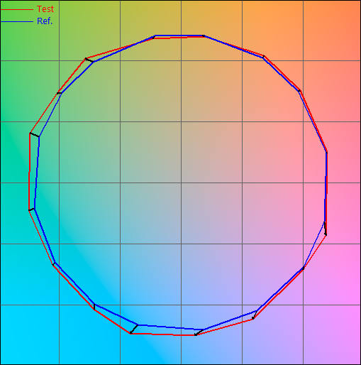

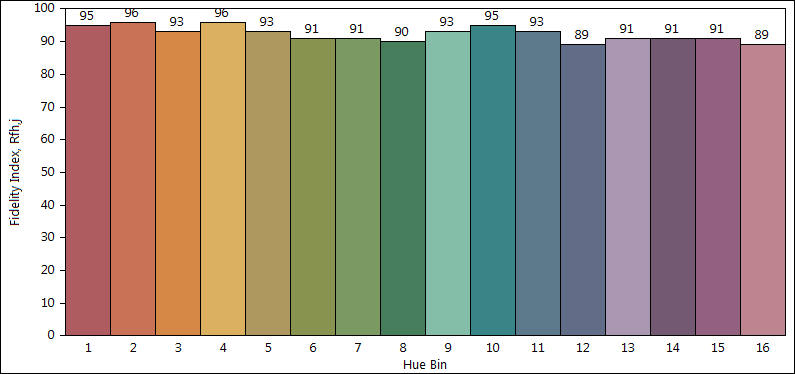

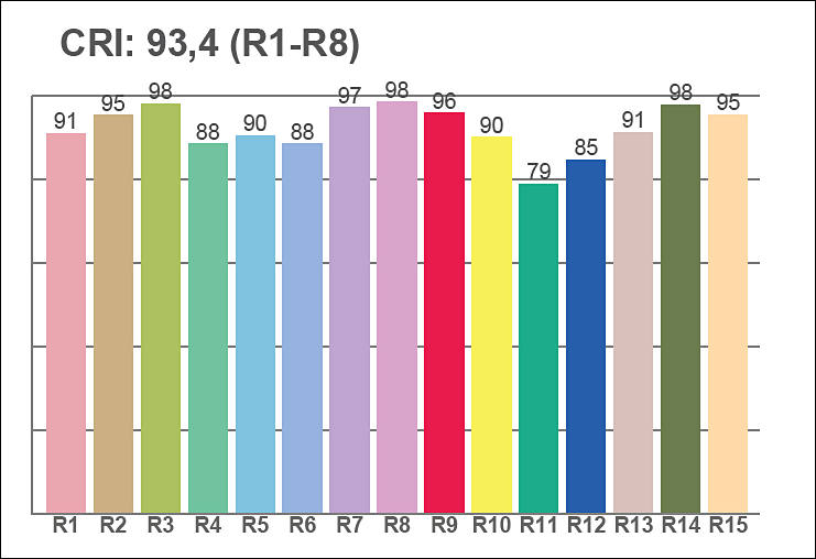

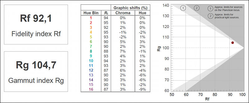

  • Ikan LCX21 Lyra 1x 2 Soft Panel (Daylight setting), Measurement using CV600, Russian Lab processing
    Focus on TM30 and CIE 224 and look for color distortion and Rf values.
    Ikan LCX21 Lyra 1x 2 Soft Panel is specific light, as it uses primary RGB leds for white light, is nod bad light, but light quality is not best for videos, especially compared to good modern adjustable temperature white led light.
    Color temperature
    CRI color quality
    CQS color quality
    TLCI 2012
    TM30 color quality
    TM30 details
    CIE 224 2017

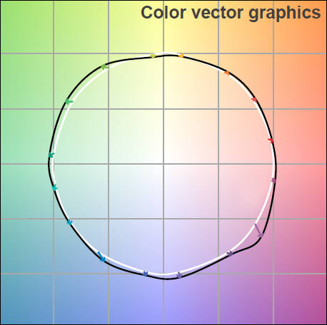

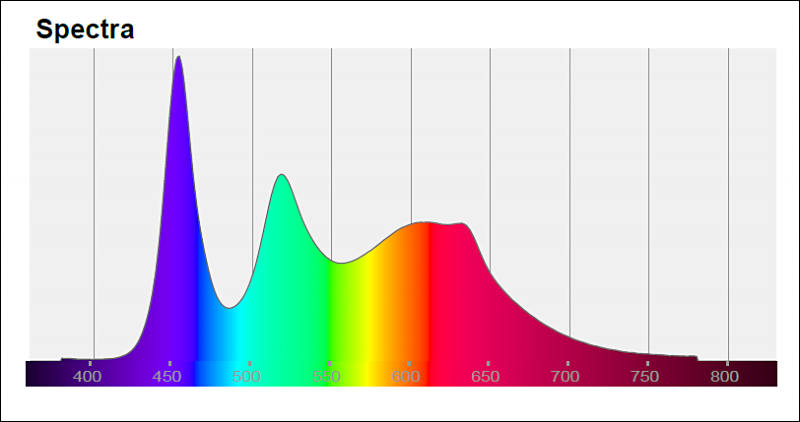

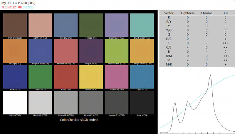

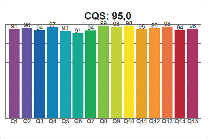

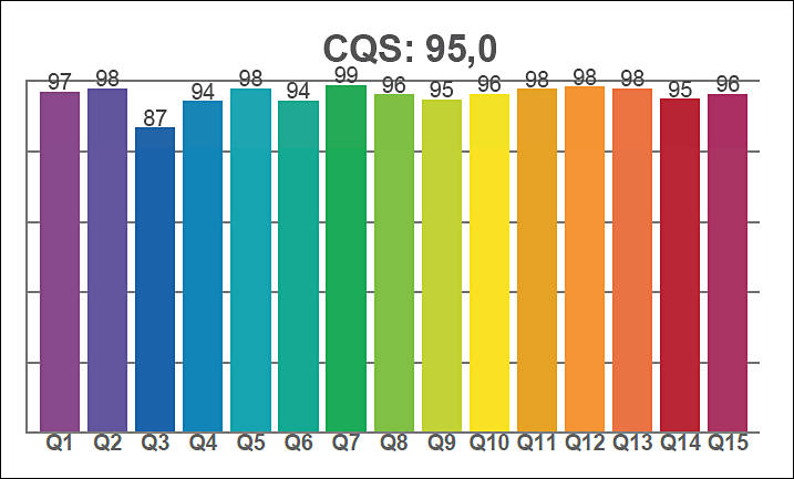

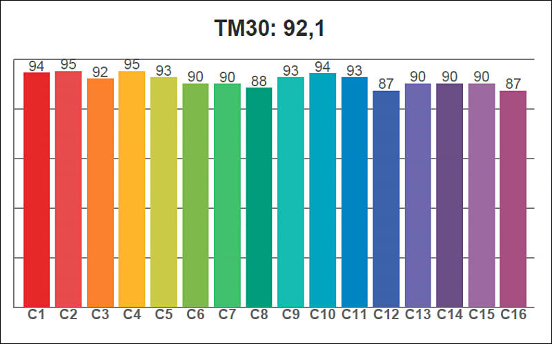

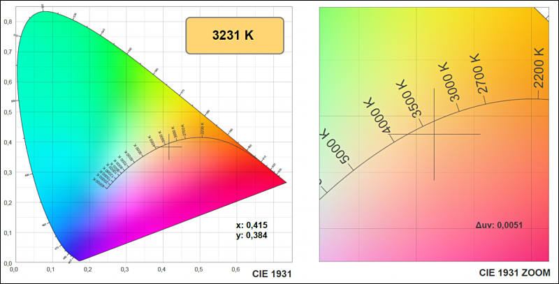

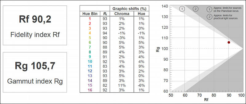

  • Ikan LCX21 Lyra 1x 2 Soft Panel (Tungsten setting), Measurement using CV600, Russian Lab processing
