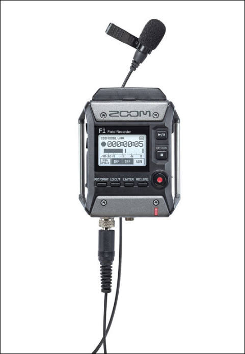

Zoom F1 Audio Recorder - take on Tascam DR10 series
    • 2-Channel Field Audio Recorder

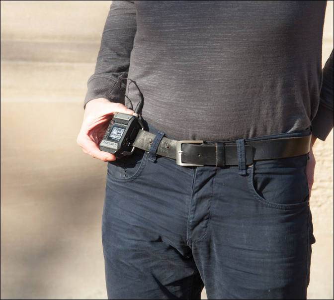

    • Attach on Belts, Slip into a Pocket
    • Compatible with all Zoom microphone capsules
    • LMF-1 Omnidirectional Lavalier Mic
    • 1/8" Stereo Mic/Line Input
    • 24-Bit/96 kHz Audio, WAV and MP3
    • WAV 44.1 kHz/16-bit, 48 kHz/16-bit, 48 kHz/24-bit, 96 kHz/24-bit
    • MP3 48 kbps, 128 kbps, 192 kbps, 256 kbps, 320 kbps Mono/stereo ID3v1 tags supported
    • On-Board Limiter and Auto-Level Control
    • One-Touch Controls, Easy-to-Read Display
    • Up to 32GB on microSD or microSDHC Card
    • Micro-USB port for data exchange to and from computer
    • Use as an audio interface to record directly to your computer or iOS device
    • Tone generator for calibrating audio levels between the F1 and a DSLR video camera without the need for an attenuation cable
    • Sound marker function outputs quick tone for syncing audio and video
    • 2 x AAA Batteries Record up to 10 Hours
    • Windscreen, Belt Clip, Mic Clip
    • Shotgun
      • Directionality: Super cardioid (3 directional mic units)
      • Sensitivity: −39 dB/1 Pa at 1 kHz
      • Input gain: −∞ – +50 dB
      • Maximum sound pressure input: 122 dB SPL
    • Lav Mic Input
      • Connector: 3.5 mm stereo mini (with screw lock)
      • Supports plug-in power (2.5 V)
      • Input gain: −12 dB – +36 dB
      • Input impedance: 2 kΩ or more
    • Available for $199 at
    • Or for $249 with shotgun module
