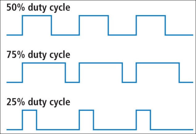

  • @Vitaliy PWM makes it look weird to me! It looks to me like the PWM only cuts in below 60 percent of the brightness, so I just keep it at 70-80 percent.
    Re the backlighting--you can't control it so sometimes it affects the tonality across the image when grading. It's a minor problem, but definitely a problem. Maybe there is a hidden setting to disable it... Many large monitors have problems with grey uniformity across the screen, the Samsung is decent, but I wouldn't call it great. It is definitely not the power saving feature as I turned them all off.
    Re 24p etc I don't think the monitor supports 24p, unlike my seriously cheap Vizio, but I will see if there is an app for it. An app won't help with playback from the USB. There is also a film mode that is greyed out. I have tried the judder removal on low and it seems to help, but it isn't 24p. On my Vizio, it just switches to 24p automatically (however the newer Vizio model that I briefly tried did not.....). Also, on the Vizio, if you hit the info button it shows you the frame rate. The Samsung shows just the resolution.
    Input lag-- No biggy. Not a deal breaker by any means, and I don't use it for gaming. Of course, it is a lot of real estate to cover.
    @Mark041 if you have an HDR sample (small) I can put it on a stick and play it. I haven't tried the YouTube app yet. In the menu you can turn on Auto HDR--the short description says it will then turn itself on or off depending on the source. From what I hear, at this price you won't be thrilled by the HDR mode, but it is present.
    Hey, it was $299......and black is pretty black.
  • PWM makes it look weird to me! It looks to me like the PWM only cuts in below 60 percent of the brightness, so I just keep it at 70-80 percent.
    It looks like this. Can also check https://www.personal-view.com/talks/discussion/18295/pv-lab-looking-at-pwm-of-gimbals#Item_1
