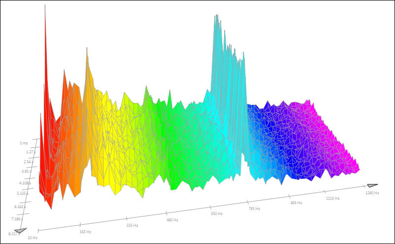

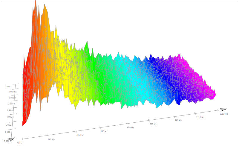

  • According to this review, it flickers at HFR. That's a deal breaker for me.
  • @_OZ
    Thanks.
    First. For PV reviews we'll test lights flicker scientifically in all our labs. So it won't be so vague.
    Second. It is just specific PWM driver implementation with too low frequency. Need to talk to nanguang about it. It is not really expensive thing ot fix.

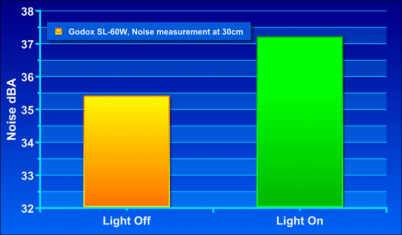

    Fan is noticeable. 200W is quite loud. If you are in a quiet space it will definitely show up on recordings.

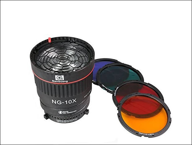

    NG-10x works well on the 60W but doesn't have the same performance on the 200W.

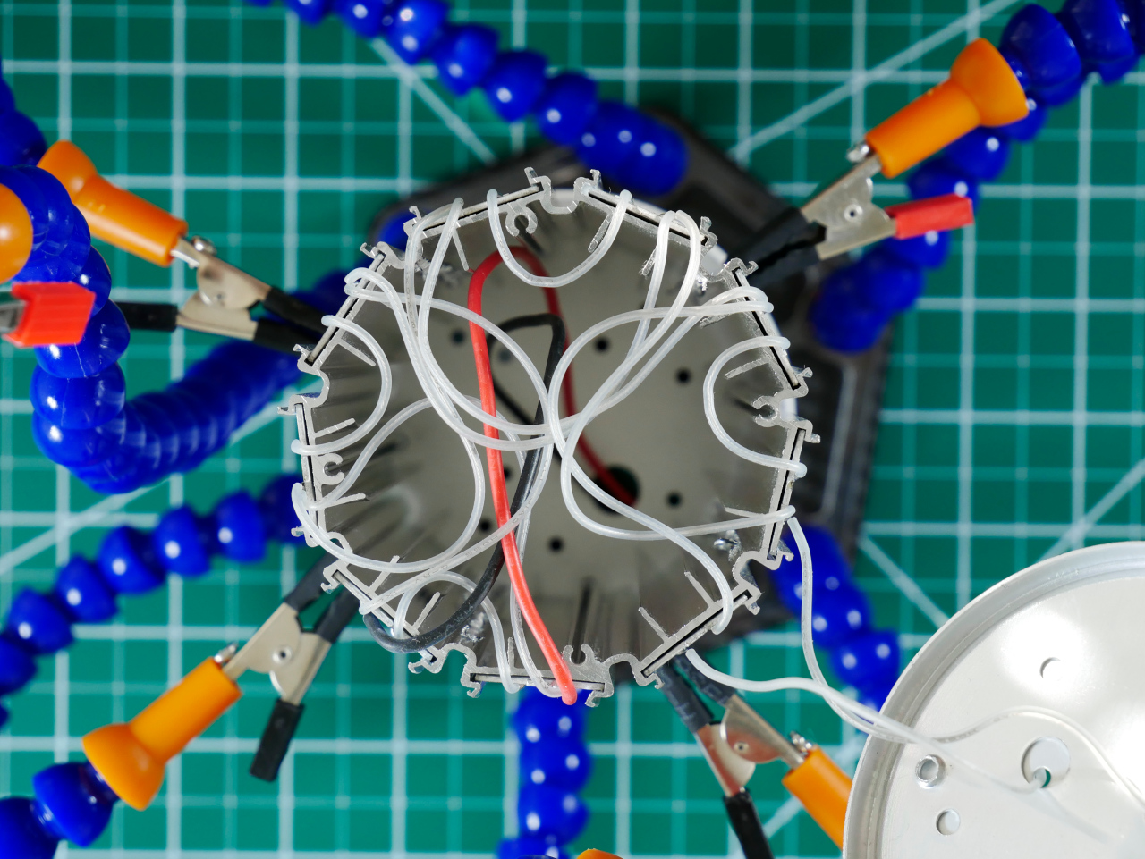

  • Yes I have dissembled and tried to replace with Noctua fans.
    Lower noise but still noticeable (don't even bother for the 200W it's loud no matter what), the design is very open with no consideration for acoustics, only cooling. The 60W has fan directly behind the COB chip. The 200W has large heat sink connected to COB, on the heat sink are 2x 80mm fans. Noctua fans will not fit the 200W without modification (cutting off some plastic on the fans).

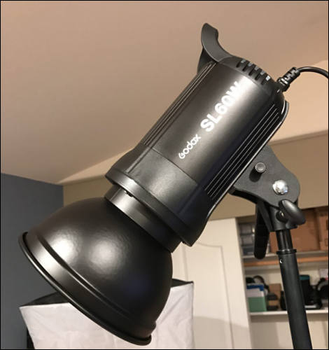

    I have the SL-200W and SL-60W with me. My original intent was to try to save some $$$.
    I was looking for a new key light I could use with Bowens mount octas and some back / rim lights.
    Right off the bat - fan noise. Unmodded it's very noticeable, like a medium-loud PC. I did some tests AFTER my fan mods in my bathroom and bedroom - about 1m away from either light you can still pick up the sound of the fan. In my opinion they're too loud to bring on the interviews, at least with the people I work with. I made some test recordings with a lav mic and hyper cardiod mic and I could hear the fans playing back with my Zoom H6 so I didn't even bother to playback on PC.
    I replaced the stock fans with Noctua NF-A8 PWM series fans with the restrictor cables @ 1750rpm.
    The SL-60W is pretty quiet but you can still pick it up. The SL-200W has two fans and they're quite noticeable. That being said, if you are using them in a "noisier" environment with other fans, computers, AC etc around, they don't add too much noise. I measured about 38db (33db ambient) for the SL-200W about 1m away (it's a $30 db meter so don't expect much accuracy). Due to the design of the units there's just nothing you can really do about the noise.

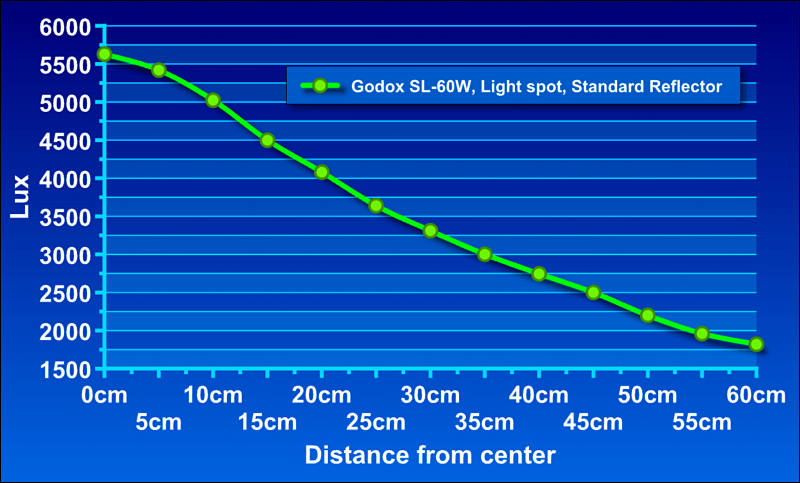

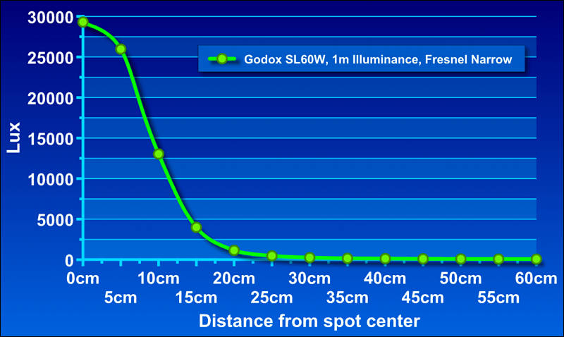

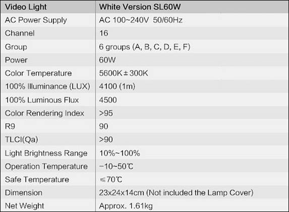

    In terms of light output... well they're pretty decent but throw about 1/2 the stated lux. The SL-200W I measured at about 6 or 7,000 lux @ 1m. The SL-60W was about 2,000 lux. Not sure what the beam angle is, probably around 120 deg like the Aputure. I have no idea where the manufacturer stated lux measurements are coming from. With the reflector on, the SL-200W threw about 18,000lux @ 1m.
    With the SL-200W and the Godox 47 and 32 inch octas and double diffusion, I measured about 2,500lux @ 1m. I made some diffusers out of frosted shower curtains instead and almost double the output @ 1m.
    The surprising thing was the Nanguang NG-10X "fresnel" and the SL-60W did about 25,000lux @ 1m at spot (beating the Nanguang CN-60F, $140 vs $400!). The SL-200W only managed around 32,000lux @ 1m at spot - but the NG-10X feels like a toy.
    Unfortunately I do not have a spectrometer so I can't comment on the actual quality of the light, but I do want to note that the lights I have are about 6,000K. To my eye they don't render skin tones as nice as the Nanguangs or Aputure stuff, but they also seem a bit magenta instead of green (my guess).
    I really wish I did some noise tests before I separated the head from the SL-60W. I feel like it was just a whole bunch of wasted effort since I don't think I'll actually use these lights on any interviews. Live and learn.
    Conclusion:
    Lux per $ these are still pretty good considering the price (about 50% of the average cost), BUT, might be useless for interviews due to the fan noise, and still have untested CRI / TLCI. I regret my purchase - they aren't bad lights (at least so far) but I'm more adverse to fan noise than I thought. However if you are doing music videos or don't need audio, they're pretty cheap so why not. The modded SL-60W actually isn't that bad in terms of noise (can barely hear it), but it's still there so if you need a quiet set these are a no go.

    Can you make set of photos and also in disassembled state?

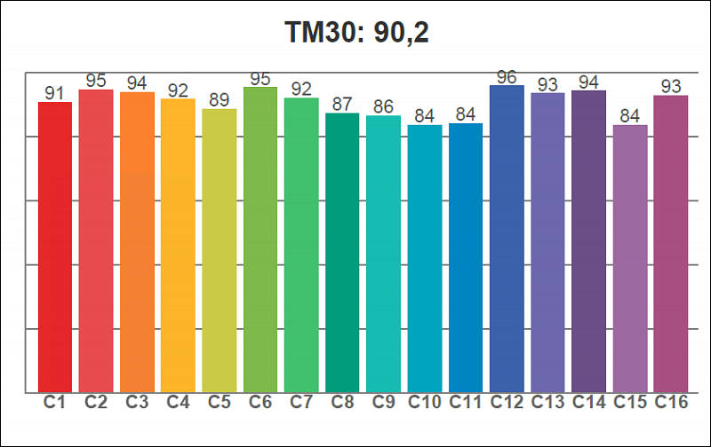

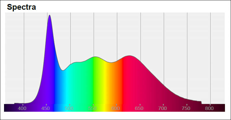

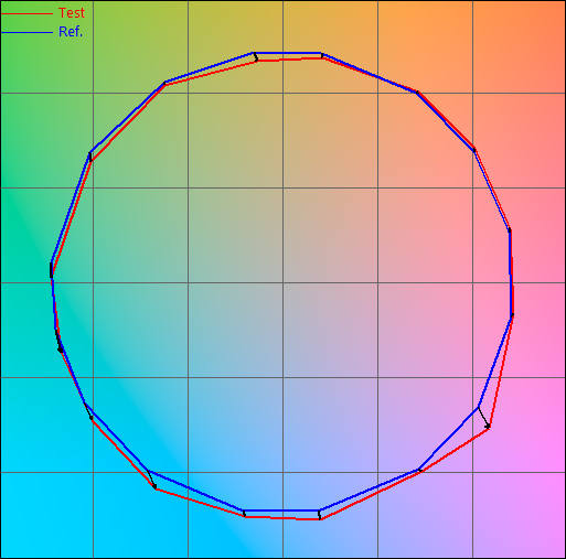

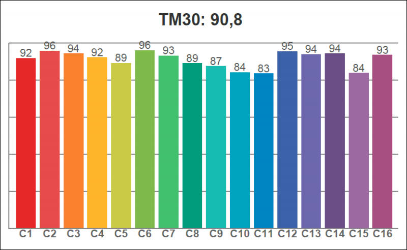

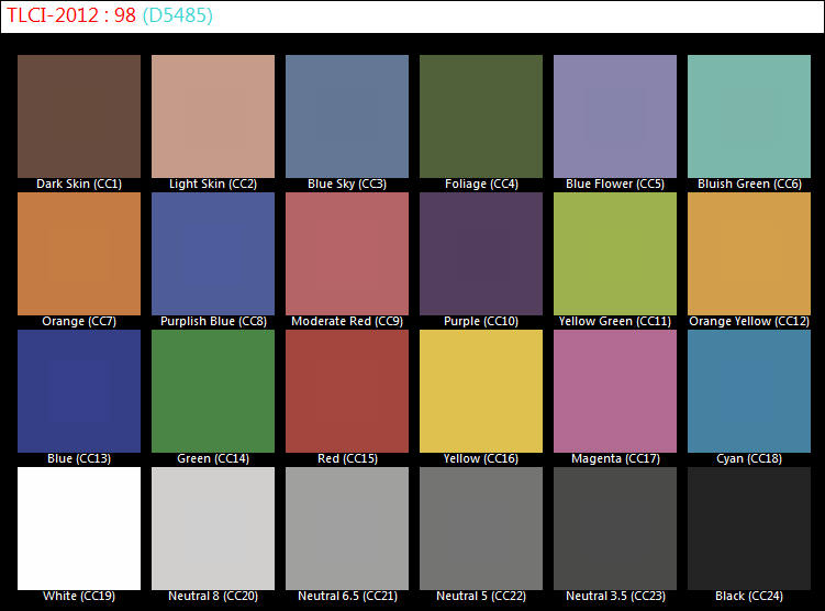

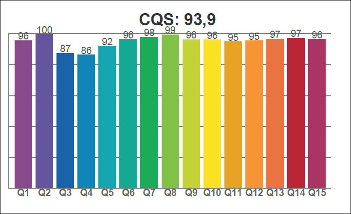

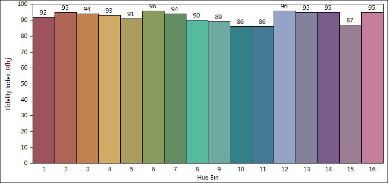

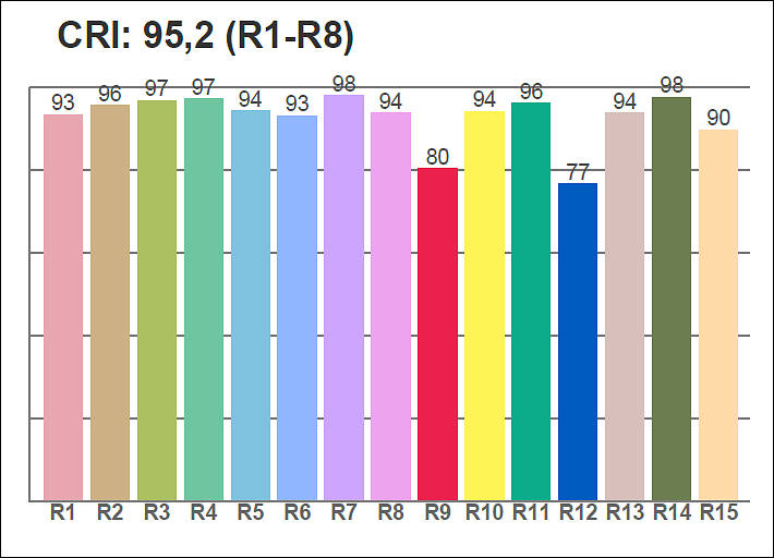

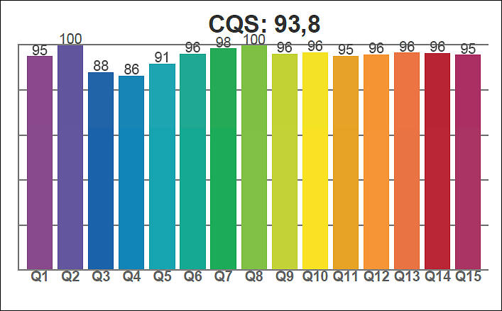

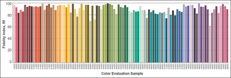

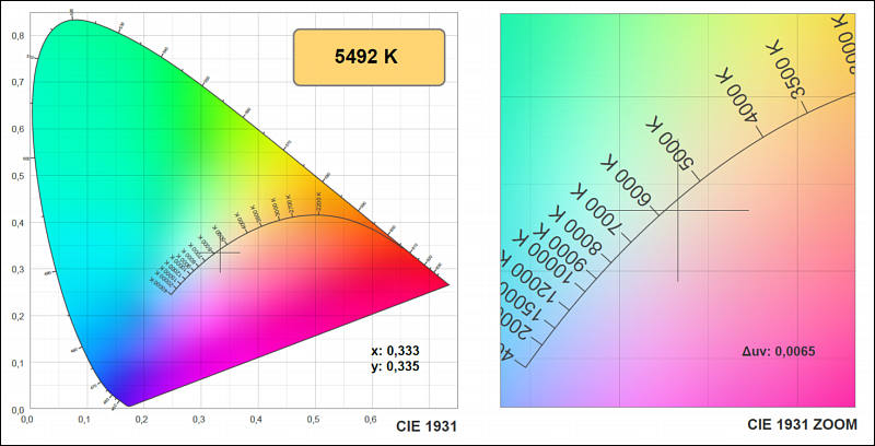

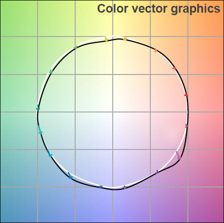

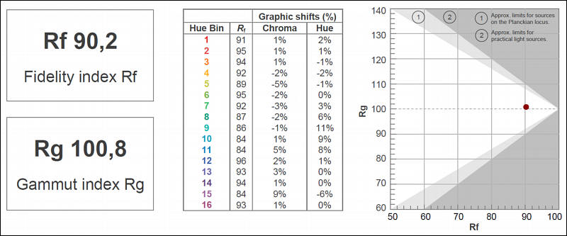

  • Godox SL60W (daylight version), 80% level, Measurement using CV600, Russian Lab processing
    Focus on TM30 and CIE 244 and look for color distortion and Rf values.
    For the price Godox SL60W is superb light with spot-on color temperature, light quality is very good. Suitable for videos.
    Color temperature
    CRI color quality
    CQS color quality
    TLCI 2012
    TM30 color quality
    TM30 details
    CIE 244 2017 (Rf = 92)

    The Godox is good $/lux if you don't care about fan noise. The NG-10X works very well with the SL-60W but not as good with the 200W. Almost 10x the lux using NG-10X without moving the LED (but keep in mind the distance between the front of the lens and the meter is now less than 1M if you don't move the LED back.
  • Godox SL60W (daylight version), 100% level, Measurement using CV600, Russian Lab processing
    Second measure at full power.
    Only indexes. All else see on top. With lowering level CRI drops slightly, TM30 almost same.
    Color temperature
    CRI color quality
    CQS color quality
    TLCI 2012
    TM30 color quality

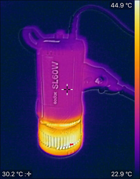

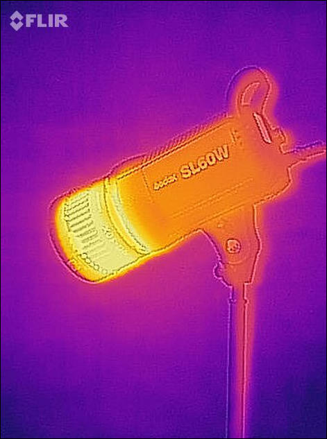

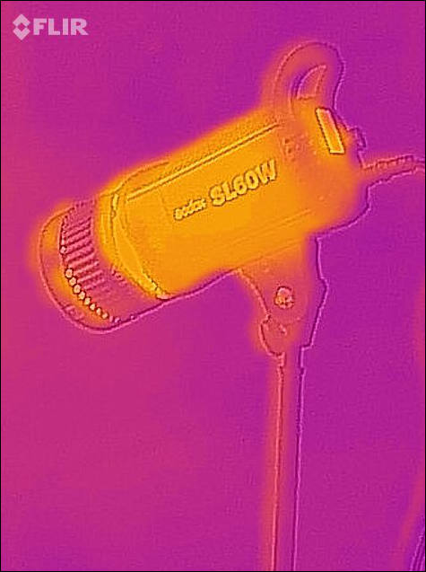

  • Thermal behavior
    Initial quick test with fresnel attachment, US Lab.
    1 minute run
    20 minutes
    Third party app
    475 x 637 - 40K
    471 x 633 - 42K
    458 x 586 - 35K

  • I have 60W one but did not use yet exept one test with small softbox when arrived . Did not know about NG-10X option will order soon. thanks for sugestion
