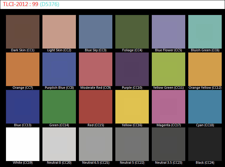

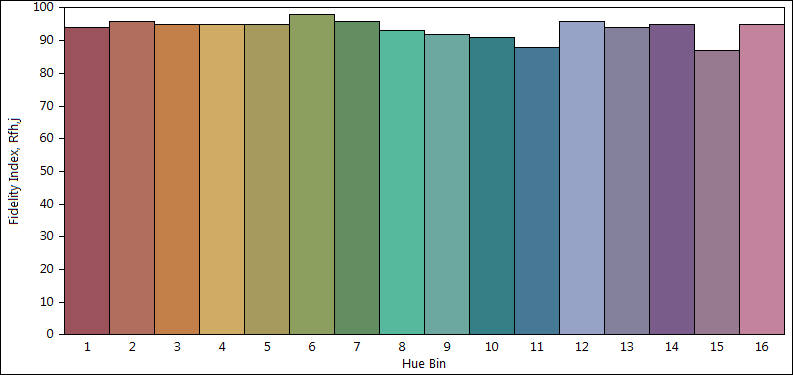

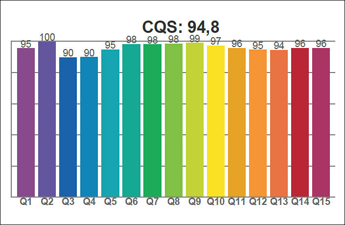

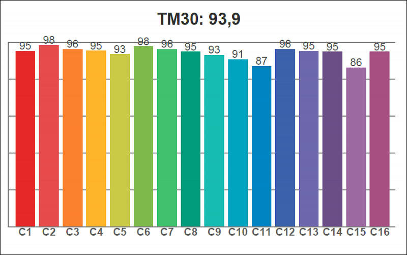

  • Out SMPTE interview

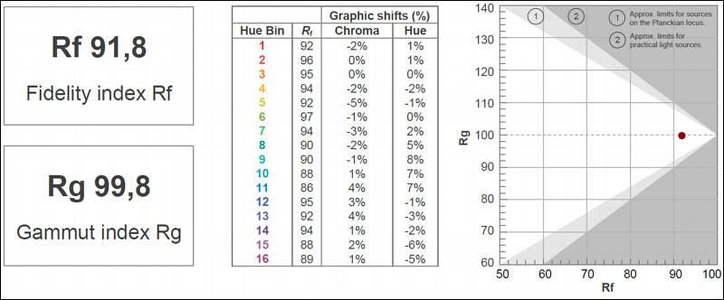

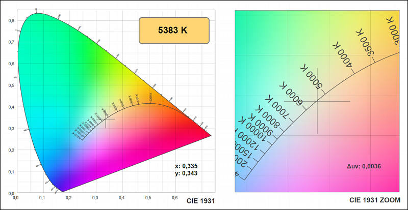

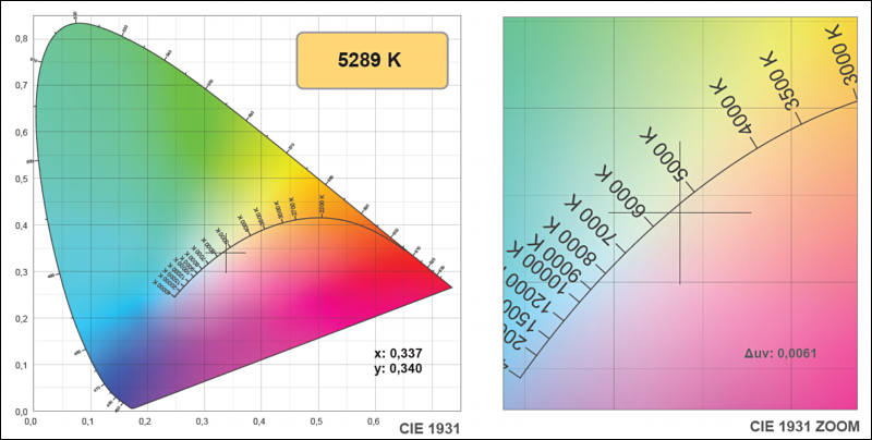

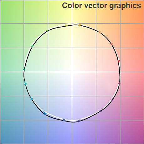

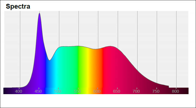

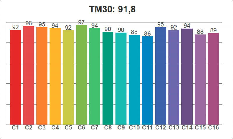

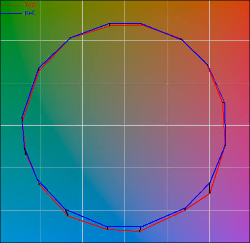

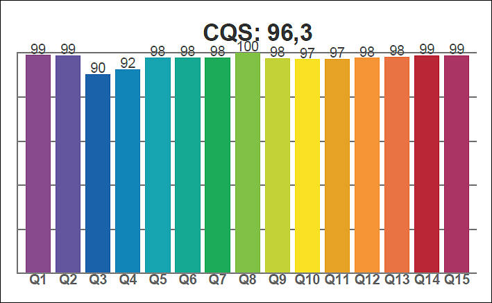

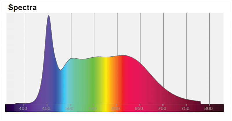

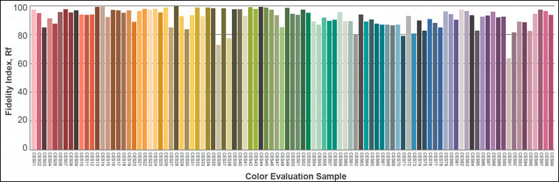

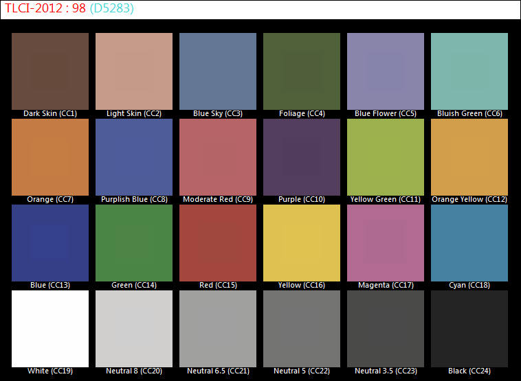

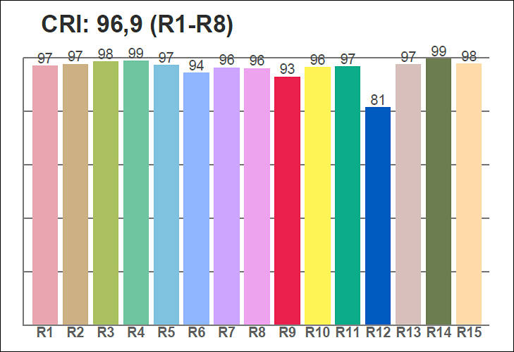

  • PV Lab measurements, CV600 spectrometer, Russian lab processing
    Focus on TM30 and CIE 244 and look for color distortion and Rf values.
    AL-M9 is very good little light with good light quality.
    Color temperature
    CRI color quality
    CQS color quality
    TLCI 2012
    TM30 color quality
    TM30 details
    CIE 244 2017

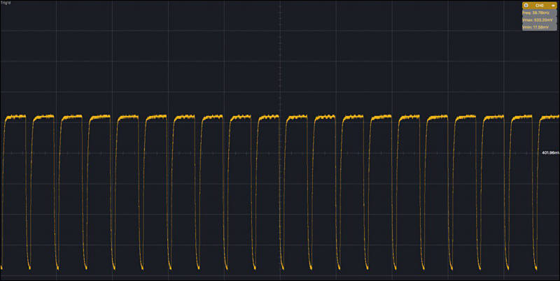

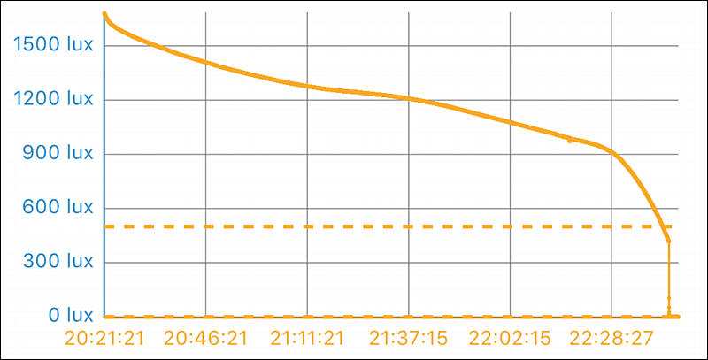

  • Note how M9 controller can't keep up output
  • This is exactly my problem. In my opinion, it makes the light useless for anything other than very short takes, yet no-one else seems to mention this in their reviews!
  • @Energy80s
    Yep, thanks. Very useful observation.
    For large lights it is not a problem as controller keeps up output.
    It is problem with controller design, I believe, made intentionally as if it'll properly rise current during battery voltage drop battery won't last much.
  • Aputure M9 PWM at 100% (battery at not full fresh charge)
    You can see that controller dim leds even at 100%.
    See above that controller can't keep output level.
    PWM Frequency is 39,8Khz

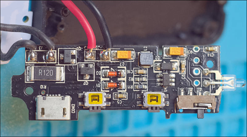

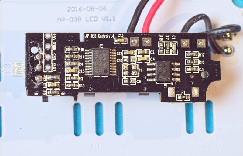

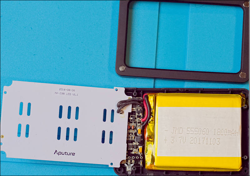

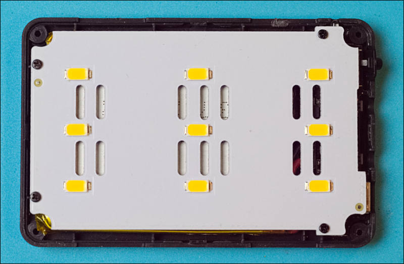

  • Aputure M9 Inside
    Overall pretty cheap construction with most prominent element - large battery
    Holes are made for battery cooling mostly
    Overall cooling design is bad, all you have for heat spreading is front board with leds.
    And it is covered with diffusion almost all the time.
    Another reason for this holes can be for them to act as thermal barrier and not led heat each other too much, but idea seems to be poor.
    Simple small board with passive components and STM controller
    Notice usage of two same black colored wires for led output, really bad things happen at manufacturing.
