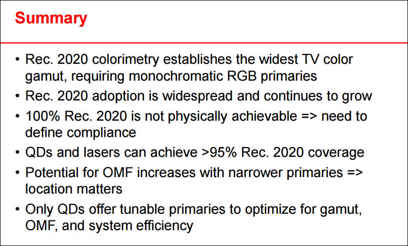

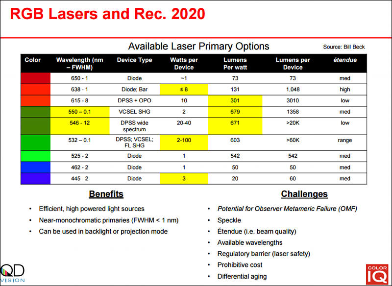

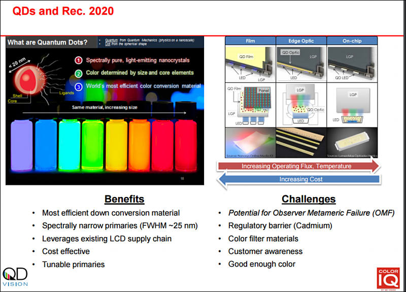

    Mitsubishi Electric showed panel prototype with 98% coverage of Rec. 2020 color space
    744 x 448 - 46K
    800 x 575 - 98K
    800 x 584 - 96K
    800 x 538 - 73K
    800 x 547 - 88K
    800 x 482 - 91K

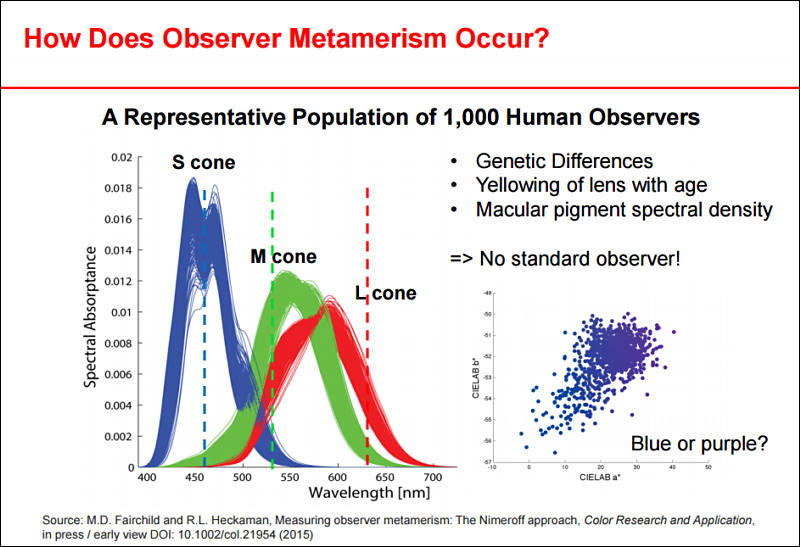

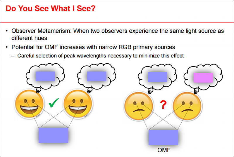

  • I wonder why the slide on observer metamerism does not mention human tetrachromacy as another contributing factor.
  • Maybe since it's extremely rare?
  • Some paper on issue
    Wide color gamut media are emerging, and observer metamerism is more and more concerned. We carried out the experiment on two different media involving color matching using real images to investigate how serious observer metamerism would be under a practical viewing condition. One media was a LCD monitor, and the other media was a laser projector. 30 observers participated in the experiment, and the data from 28 observers were analyzed. Under the viewing condition where images were widely separated (often the case in reality), the lightness discrimination was significantly decreased. It led to our decision to ignore the variability in the lightness direction when computing perceived color differences. The obtained interobserver variability was larger than intra-observer variability for all the three images. The inter-observer variability was 3.2 to 4.4 in MCDM (∆E00, a∗ b∗), which indicates observer metamerism would be significantly apparent when a laser projector is viewed together with conventional media. Image impression could be perceived in a opposite way (a person may see an image as ’warm’ whereas another person may see it as ’cool’). It was found that effective visual angle (or field size) is dependent on image contents. The more complex an image is, the smaller the effective visual angle is. Solutions should be provided for observer metamerism in wide color gamut media, such as color management personalization.
    http://www.cis.rit.edu/~yxa8513/Publications/Paper_CIC2014.pdf
  • More on topic
    In designing color primaries for accurate color reproduction, spectral characteristics do carry significant importance. A move towards monochromatic color designs such as are found in laser displays adds significant chromaticity gamut area for users, but at the expense of observer metamerism and variability. Investigation of real displays designed around three current color standards for motion picture work reveals that the latest specification, ITU-R Rec. 2020, offers strong potential for viewer disparity when compared with older broad-spectrum standards like ITU-R Rec. 709 and SMPTE 431. Expanding to more than three laser primaries can help, but only if those wavelengths are themselves optimized to the objective of improved observer consistency. Attempting, instead, to simply generate the largest color gamut possible from multiple laser wavelengths may actually exacerbate metamerism failure. Finally, it is possible to craft customized primary spectra with the intent of minimizing observer metamerism. A prototype seven-channel projection system at RIT has been constructed with modeled results significantly improved over any legacy three-color display
